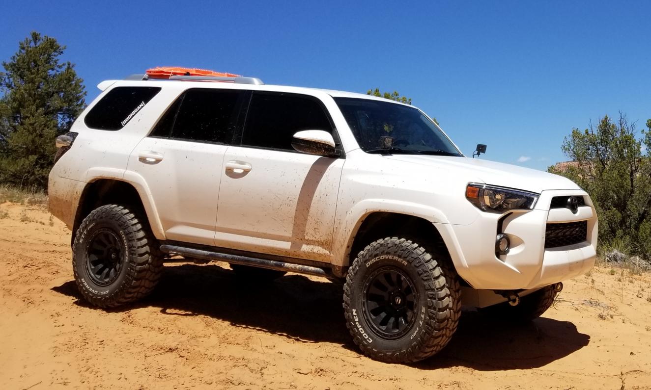

I have a Toytec Ultimate that includes 5100 bilstein's with 650# front springs, and Toytec Superflex rear coils with extended length Bilstein 5100's.

Just out of curiosity, have you considered the Eibach Pro Truck Lift? It comes with front and rear springs and shocks. The front is 2.75” and rear is 1”. The front is also adjustable for when you had more weight. It’s all engineered together so you know that everything is designed to work together. Check out the Eibach Lift thread. I have pictures of my lift on my 2019 TRD ORP.

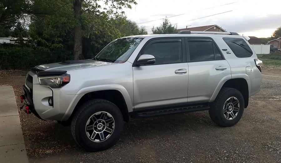

I have the Toytec Superflex 2" rear (RCC2.0) paired with Bilstein 5160's. I don't really mind the rake with the approx. 3" front lift I have - but it's def noticable IMO. Anything less than 3" up front, paired with the 2" lift in the rear will be a lot more noticable.
My gripe with these rear springs/shock combo, is the nasty hop it has while going over bumps. My intention is and always has been to purchase a steel rear bumper/swing away tire carrier. But how it rides right now, you basically have to bring it under 5mph so the rear doesn't bounce like crazy!! - unless you like that sort of thing :girl:

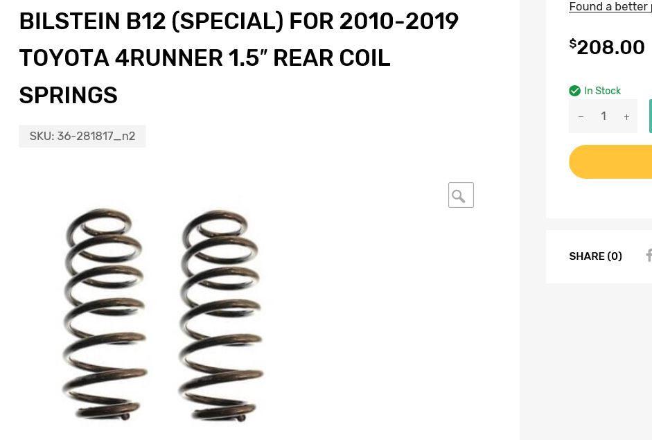

If I could to it all over again, I would have gone with the 1.5" springs by Bilstein pictured below my rig...
