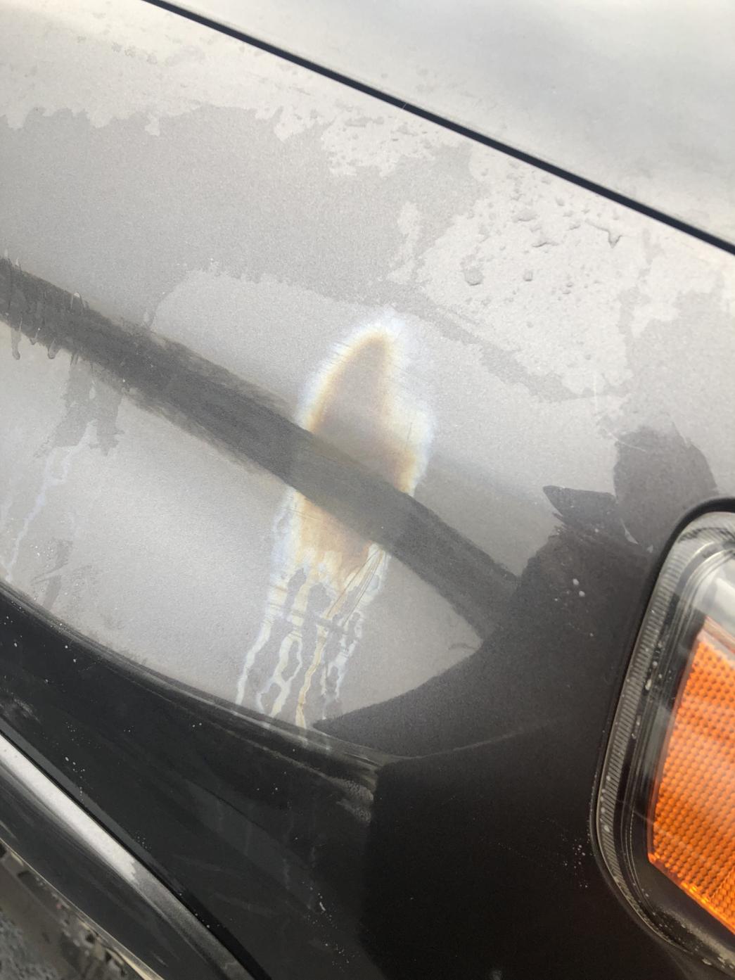

So my trusty spot at work was taken and I was forced to park under a pipe. For reference, I live in NY and park in an older underground parking lot. It appears that water dripped off the pipe and onto my car. I have scrubbed with soapy water and a brush with no effect. I briefly ran my finger nail and it appears to take the surface off but its still discolored.
If anyone has any advice to safely get this off the paint, I’d appreciate it! Thank you.

I would start with a claybar to remove any paint contamination and then do as suggested above with rubbing compound and then polish.
iron-x and claybar or clay towell then buff with a non-agressive compound like the meguires suggested
or just file an insurance claim.
if it was me i'd try to remove the contaminants and try some light buffing but would file an insurance claim and pay my $50 and let a bodyshop deal with it after that.

I spoke with my office building's landlord and they are sending a company to "buff it out" within the next 2 weeks. I think I am going to take the advice of those so far and try to bar it out and then use meguiars.
I am honestly hoping it doesn't need paint work and can't believe that a stain that has been there for no longer than two days could do permanent damage. :redbrick:
Clay and cleaners is the way to go. That said if you are very very carefully use Acetone..it may prove an acceptable last resort. Use small amounts with a clean cloth. Do not scrub or use hard pressure. Basically you want to just take off a minute amount of the top clear. Careful you dont dig through the clear. Use clay and other cleaners first. Acetone..is the end bit.
The colouration looks like some sort of oil/petroleum type product in the drip.

don't touch it.
the minute you touch it it's now your responsibility to fix it.

That was my first instinct but I'm worried about two things:
1) Whether whoever they are sending will competently do this and not mess up my paint further;
2) A mitigation of damages issue, in that the paint gets worse before they come to fix it.
I do understand your point though. I find it very stupid to even be in this position.

I understand your hesitation. I’d try to treat it myself on a small test area before letting someone else attempt a remedy. First, get that oil off, if that’s what it is. Try a solvent like naphtha, such as Coleman lantern fuel, white gas. That will safely remove oil or grease. I would not use acetone. Use a soft cloth or a q-tip first on a small area. If it works continue on the whole area. Then follow it up with isopropyl alcohol, 90% if possible. Of course be careful due to flammability.
Then try one of the polishing products previously described to remove the rust.
Here’s an article with some more detail.
Removing Rust Stains From Paintwork | Car Cleaning Guru

The building is working with you to get it fixed. I honestly would have them try and take care of it. Don't give um any outs to not finish the job correctly.
Now if they said go pound sand I would try my self.

you touch it, the building can't fix it and they go "well customer tried to fix it and made it worse, we can't take responsibility for that".
You don't touch it and building can't fix, you get insurance involved and building pays to have it repainted
Thank you everyone for the suggestions. Got impatient and did it myself. Took a good while with a clay bar but got it all off.
