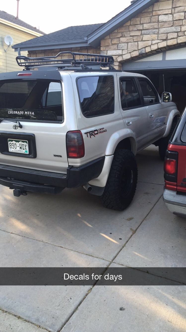

I installed them a few weeks ago and they looks great! It was pretty tough to do actually... I taped the top side and peeled the sticker off as I went down... I've heard of people using soap and water and squeegee the access out? Idk how well it would work but it seems smart... Mine look fine and not many bubbles so there's one option...
