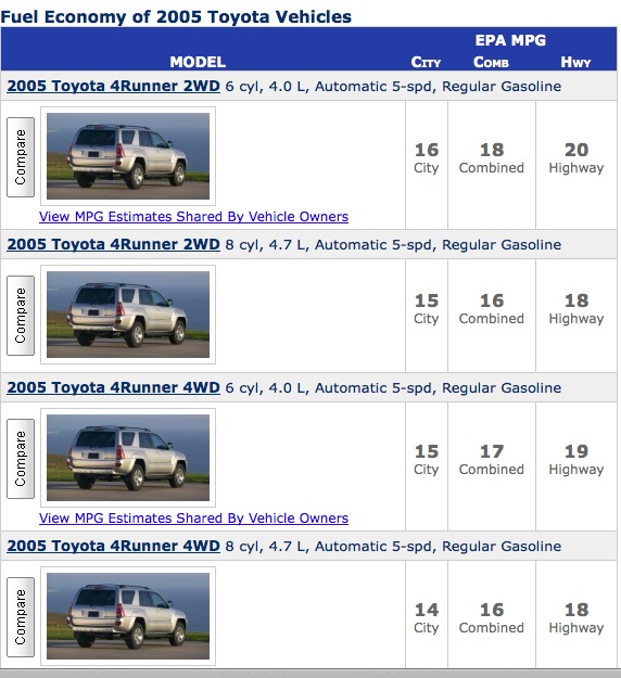

These numbers got me curious so I looked at the gov EPA site to see what my 2005 is rated at. It may, or may not, provide some insight.

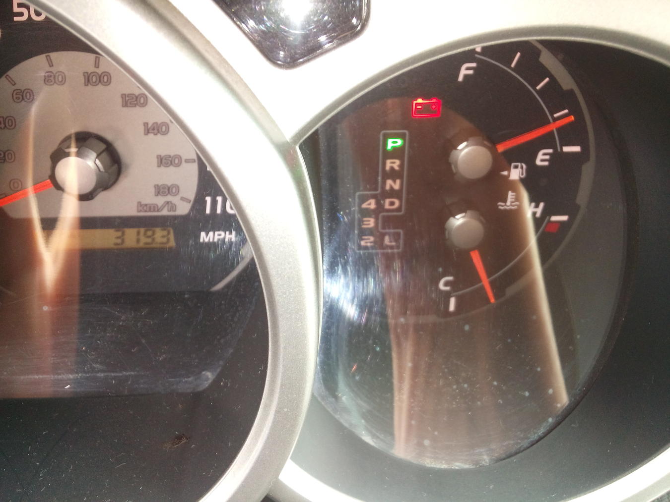

REcently went on a 350+mile trip...filled my tank b4 the trip was averaging btw 65mph to 85mph...95% highway . at the end after roughly 320k miles....had a lil below quarter on my tank, ultraguage siad 92liters remaining, while the indash display said 56miles (recently installed the UG, nad hv calibrated/tank fill ups twice or thrice)
Well, did some more research on it last night, seems like the consensus for an 03 V8 Limited 4WD is 15 city 18 hwy, I guess I'm not doing too bad then...
