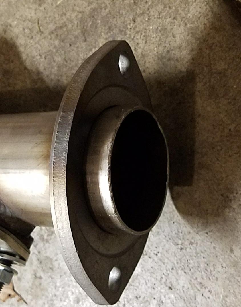

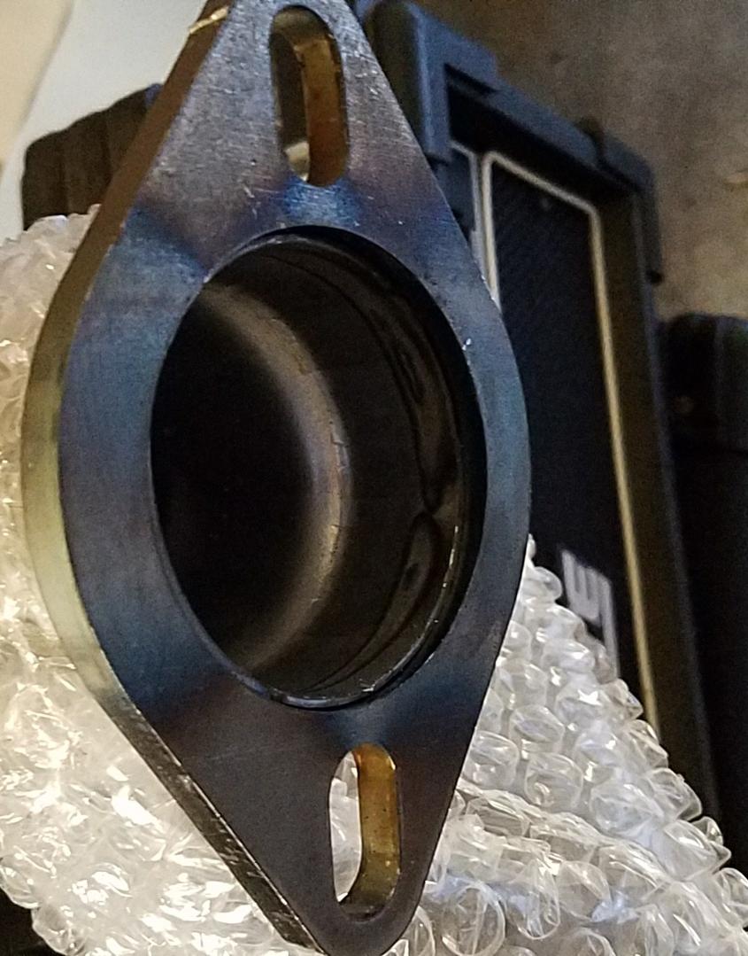

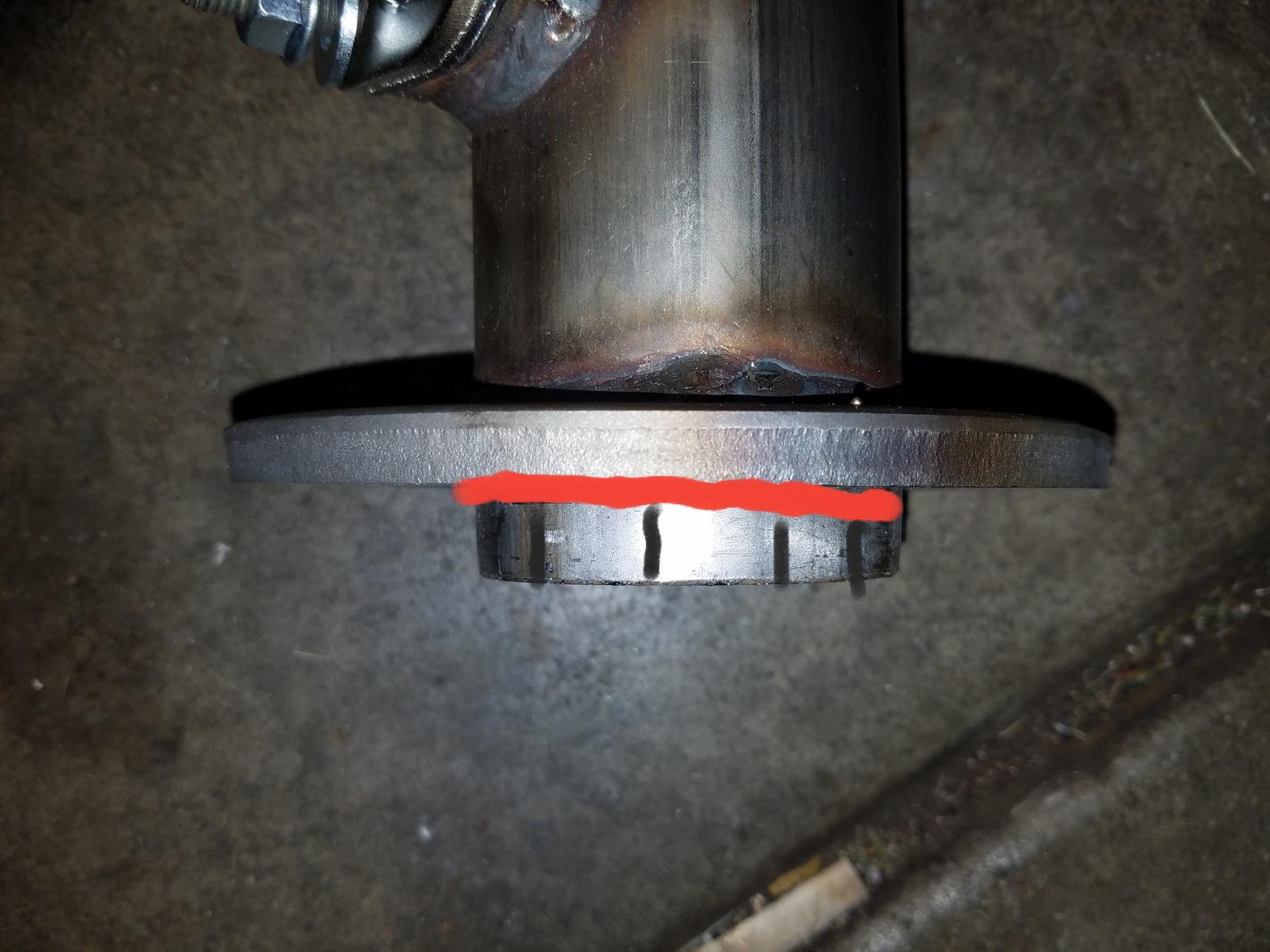

Got the two Magnaflow cats and the Walker Quietflow muffler/tail pipe. The male extension coming off the back cat will not go in the female flange on the muffler by about the wall thickness of the Magnaflow pipe. I believe the Magnaflow ID is the same as the expanded OD on the Walker. My only thought is to make slits in the male extension on the cat so it can collapse a little and hopefully go in far enough to get the flanges to come together and seal. Ideas?? I want to get this damn thing installed...

With the proper tools you could remove 1/16" and see what happens. Or try two gaskets.
if you want the quick and cheap solution, grind off the male flange flush, and find a fitting gasket or use copper gasket maker between the flanges.

Thanks for the replies but let me clarify... it's not a length problem, it's a diameter problem. I'd prefer to keep some material instead of cutting it flat and merely using bolts to secure the two together.
I had this same issue on my 3rd gen. The male exhaust pipe that extends about a 1/2" past the flange ends up getting stuck on the exhaust pipe/welds that are inside the female flanged section, preventing the 2 exhaust pipe flanges from bolting together flush. Like others have said, you need to trim some material off the 1/2" exhaust pipe that extends past the flange. Once you do that, the exhaust flanges will bolt flush. Also purchase 2 or 3 of these gaskets to go inbetween the connection. More Information for WALKER 31374
I ended up trimming some of the pipe and using 2 of these gaskets together, I have had a leak free seal for a few years. I used an angle grinder with a metal cutting wheel if I remember correctly. A dremel will not be powerful enough.
There we go... exact same issue as mine. I believe it to be the difference in manufacturer. Magnaflow sees a 2.5" pipe as an inner diameter measurement and Walker sees it as an outside diameter. The mindset between the two is probably "performance" vs "economy".
The male flange is stainless and hard as hell. I've got a good angle grinder and will probably do a little of both in shortening the flange and giving it a couple cuts to help it contract and slip into the recess of the muffler.

So after speaking to Magnaflow I think I've determined it's the Walker muffler flange that's the problem. Since my stock stuff is still on and will more than likely need to be cut to come off i can't say 100% forsure. Some of the reviews on the Walker say they had problems similar to mine and some say it fit perfectly... go figure.
The Magnaflow pipe is 2.5" OD and the Walker inlet is about 1/16 smaller. Pisses me off...
By chance does anyone have a rear oem cat they can measure the rear extension flange? On the Walker site they list the muffler inlet as 2 1/4". A LOT of aggravation over 1/8"
