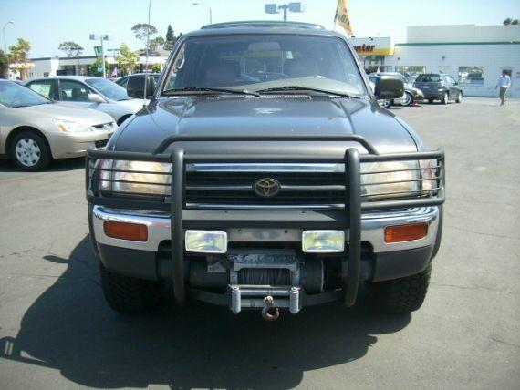

Weld a plate onto the brush-guard to mount the winch, I've seen it done on our 4runners. Image attached, Saw that on cars.com a while back.
That may be a good option. Right now I have it mounted on the upper part of the brush guard, but I used it this weekend and it pulled the top brackets loose, but if it was lower, it would make use of the frame mounts, and work better. Thanks, good advice.
