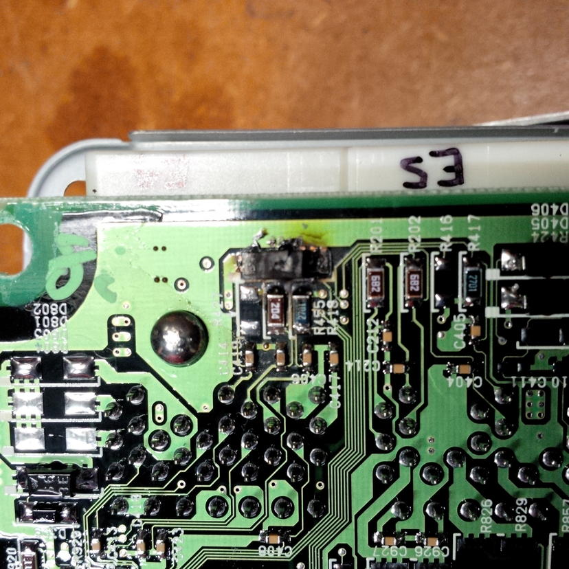

Yep, I understand the slim chances but at this point what do I have to lose? A new one would cost 1k, then add in reprogramming, taxes and whatever the stealership intend to top it off with, verses 2 bucks for a diode some solder and my time. Even ECU repair services state that not all ECU can be repaired, however, just to get the ECU diagnosed to determine that runs about $200 bucks. So, let's see what happens if I just replace the diode, only issue is finding the correct part to replace it with. I already know that this is just one issue, cause I still have the other issues to debug (VSC & ABS originally).

Shot of the blown component, which I believe to be a diode, just can't make out the markings, too burnt. Anybody know what this is? It is in location D409.

I would think chances of finding documentation on a level that would identify something as specific as a diode would be slim to none. However, you should be able to identify it by looking at a board that is good. Would you be able to get someone to send you a picture of a good board?
The problem I have found with repairing unrelated circuit boards in the past is that components that show visual signs of damage are often a symptom of the real problem, not the cause. You may successfully repair it only to find you toast another one. Troubleshooting can be difficult without a thorough understanding of the circuitry.
But, you don't have much to lose giving it a try. Worst case you still have a bad ECM.
Another quick thought, Zener Diodes are typicaly used as protection devices and in power supplies to generate reference voltages. Certain sensors require a reference voltage to operate correctly. Sensors like the TPS and MAF sensor for example use a reference voltage that is constant so the ECM can accurately read the signal coming from that particular sensor. I would get a service manual with the pinouts of the sensors and try that. If there is no reference voltage, the ECM cannot read data from the sensors and therefore cannot control the ignition timing, injectors and the VVT actuators. Can you connect a scan tool and read any data?
Update: Having no luck in identifying the blown part in location D409. Did get to actually talk to a Toyota Technical Region Rep, but no dice on the schematics or component information on the part. Apparently, this is still proprietary which "is still in Japan". Was suggested to purchase a used ECM to at least get the engine cranking again. I'm still on the fence about a used ECM. Noted my disappointment to Toyota Corporate, no response after two days. Even though I have other issues besides the cranking issue, just got frustrated that Toyota would just leave their customers high and dry. Just vetting here folks. Oh, BTW, scan tool cannot communicate, no link.
