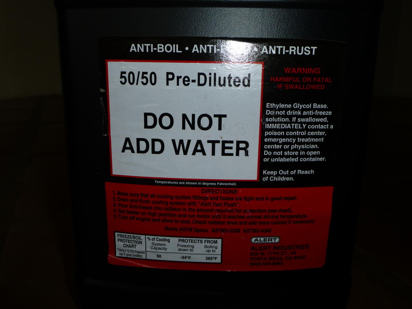

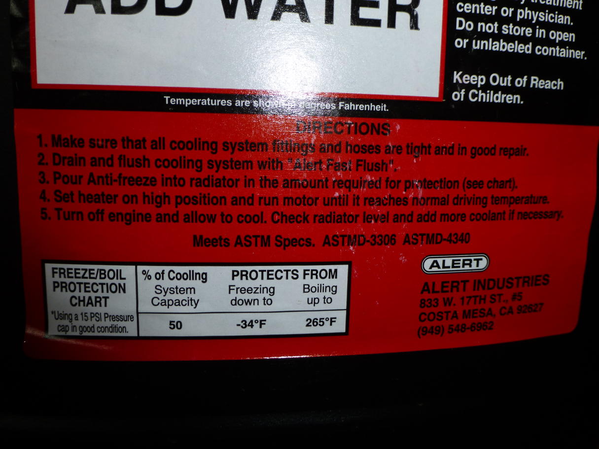

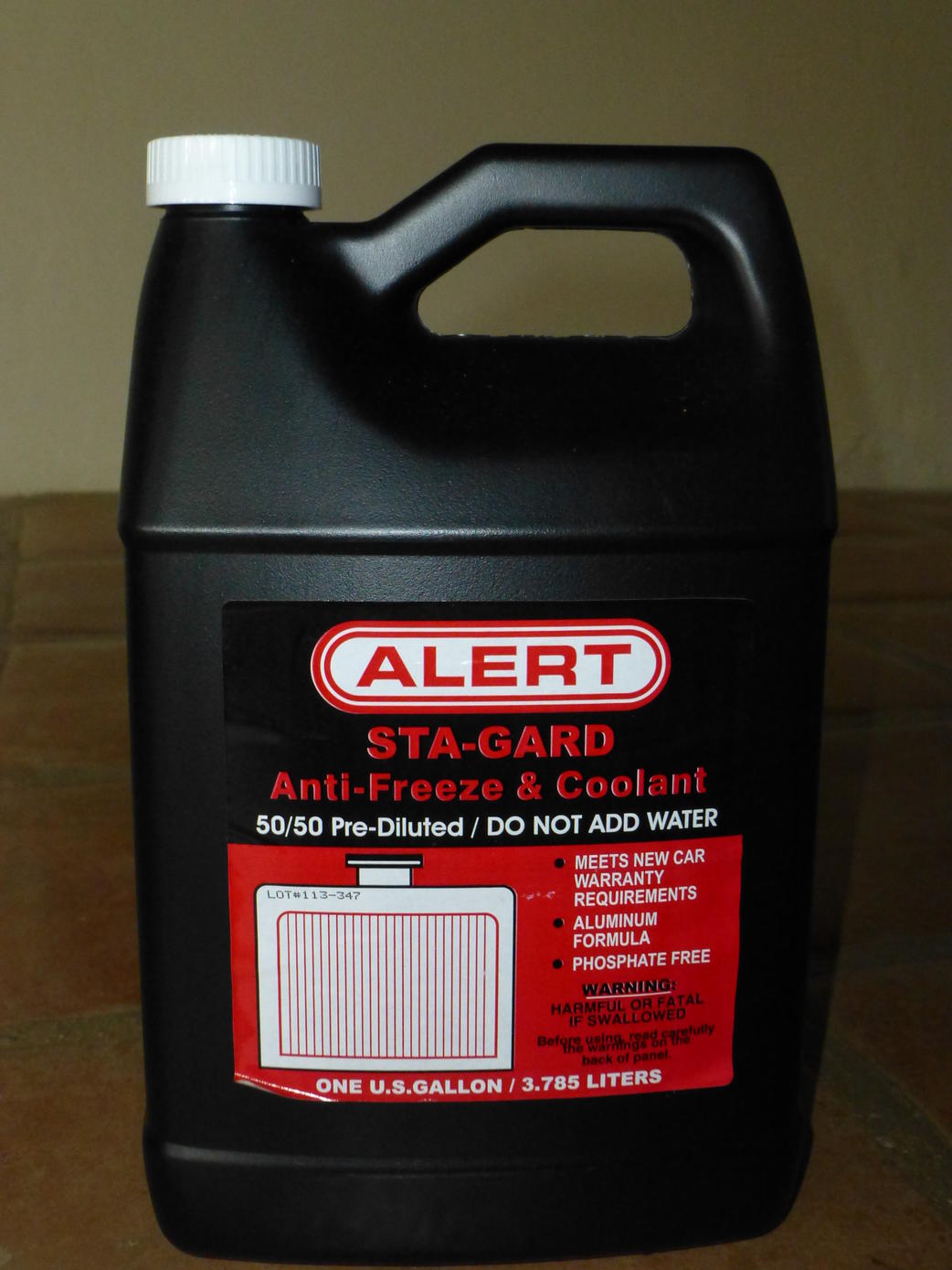

Well I couldn't find an online link or picture. Google pulls up nothing on this brand, so now I am worried. I questioned the guy at the dealership and he swore up and down that it is the same stuff. They had the Toyota brand SLLC too for sale but said he even uses the Alert stuff for his Tacoma. Here are some pics I took. Any thoughts?

I tried to look up the company online, they don't seem to have a website; I did find a couple company profile indicating they seem to be a wholesale distributor of some kind. Unfortunately I could not get any data sheets on their product, nor did they respond to my phone call.
I would ask the dealership that sold you the coolant to provide paperwork proving it meets Toyota's SLLC requirements.
Toyota SLLC (Super Long Life Coolant):
~Elthylene Glycol Based
~Non-Silicate
~Non-Amine
~Non-Nitrate
~Non-Borate
~Long Life HOAT (Hybrid Organic Acid Technology)
If it doesn't meet ALL the above requirements it is NOT a compatible substitute for Toyota SLLC and does not meet the requirements for the engine's cooling system and could result in long term damage. The Dealership should have no problem providing you with the Alert Coolant's Data Sheet, after all they SHOULD have checked that before ordering and claiming it is an acceptable replacement for Toyota SLLC. The reality is that Ethylene Glycol is clear when it is first manufactured, the various colors are due to branding/corporate desire and not to differentiate what it has in it (for example old pre-G10 Coolant is still green like modern day G11+ Coolants, BMW Blue Coolant is different than Honda Blue Coolant, ect ect.), Zerex Asian blend has a "Chameleon Color" which is yellow because it typically blends well with almost any dye. So you really need to know what is in the bottle to be accurate, many websites and manufacturers do not seem to post all the ingredients of their coolant which makes finding an aftermarket one even harder.
