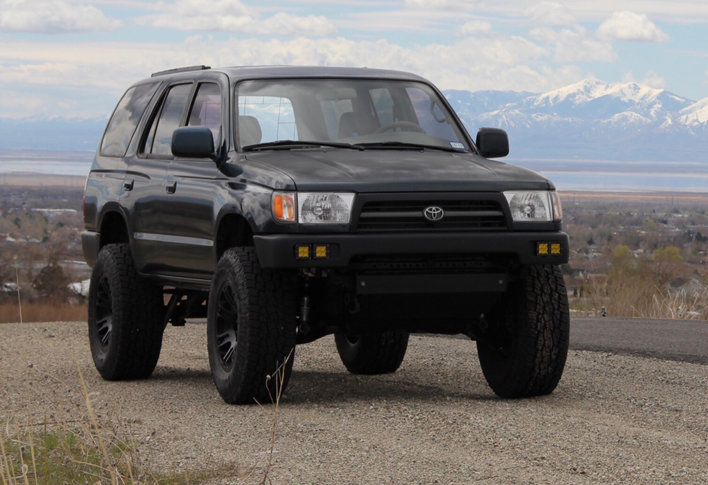

T1s and 5100s here, seems like about 3” unless someone else looks at this and tells me im way off.
Ride is very nice but my only comparison was with trash struts and RC spacers.

Looks good. Which 5100? And which perch? Ride quality? tnx
4runner 5100s, bottom perch
Rides great but again, when i bought the 4R it had crap struts and spacers so that is my only comparison in this vehicle. Its significantly softer than the previous setup but not so much that i feel like it gives too much at all.
