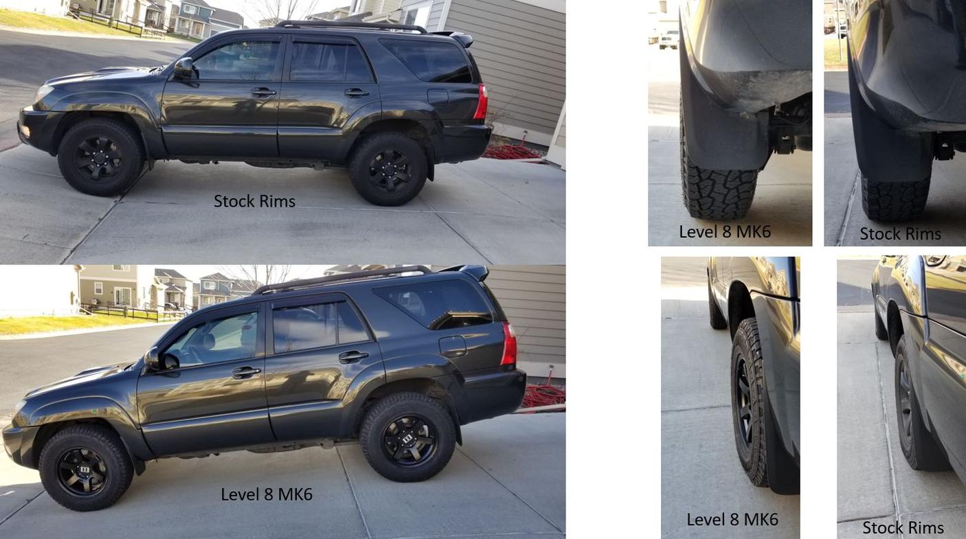

I have the 0 offset but have 265-70 tires and they stick out just a tad. Very minimal. If you want them sticking out, get the -10. Flush, get 0.
MK6 vs. stock sport
Here are some photos of my stock rims (sport) compared to MK6. Stock tire size. MK6 is with 0 offset.

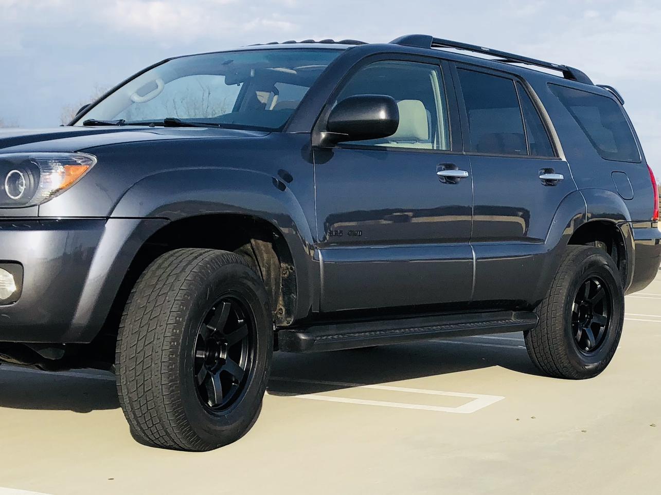

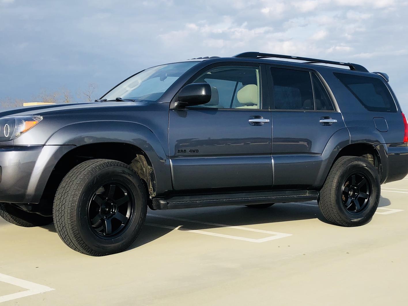

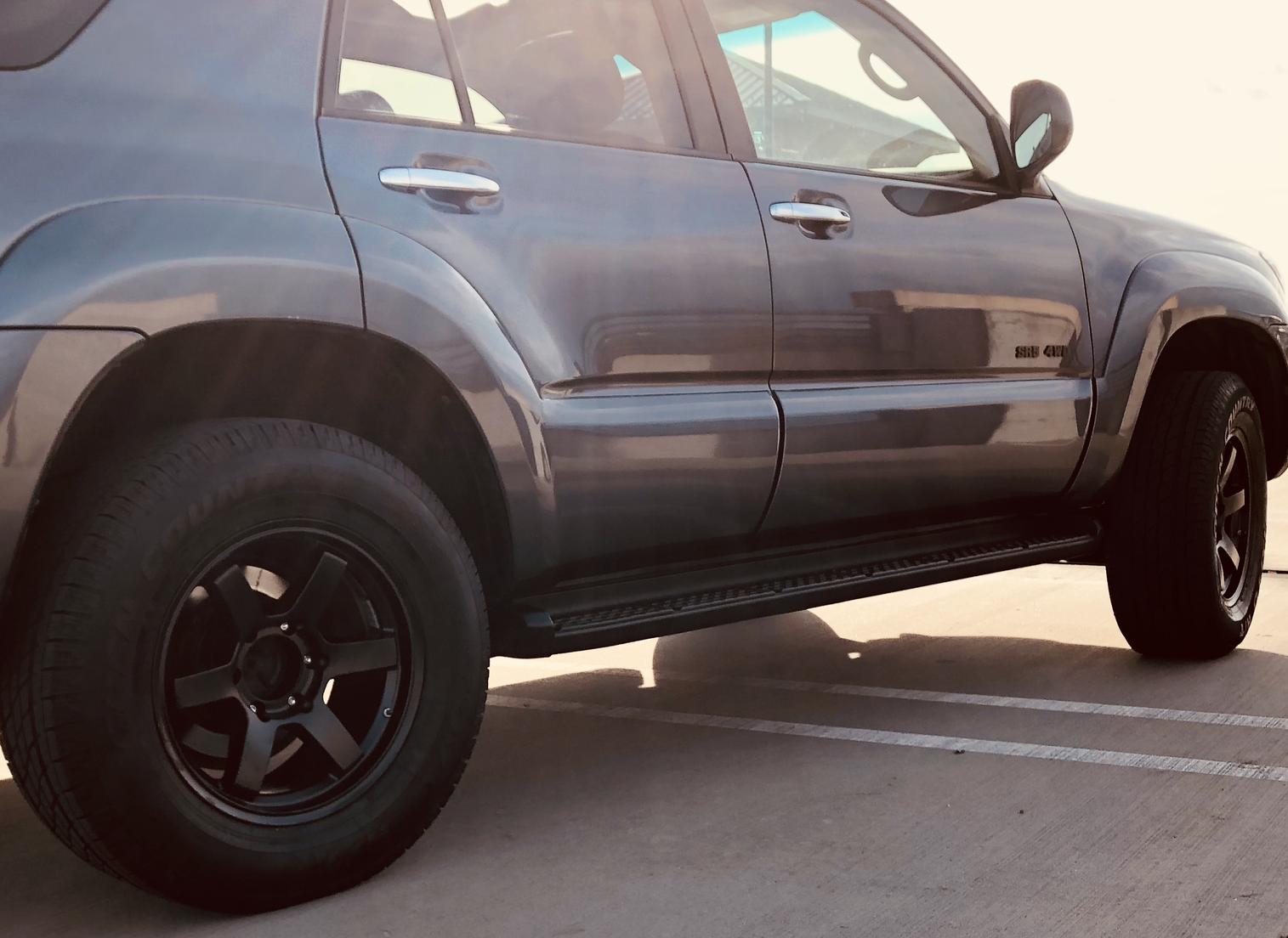

New Wheels installed!
Discount tire just installed them today and couldn't be happier! Went with the 17 by 8 with -10 offset which put the wheels about 1.8 inches further out than stock. Also went ahead and removed the front mud flaps and trimmed the rear ones to be flush. Also added a chip guard to keep the paint from getting messed up.
