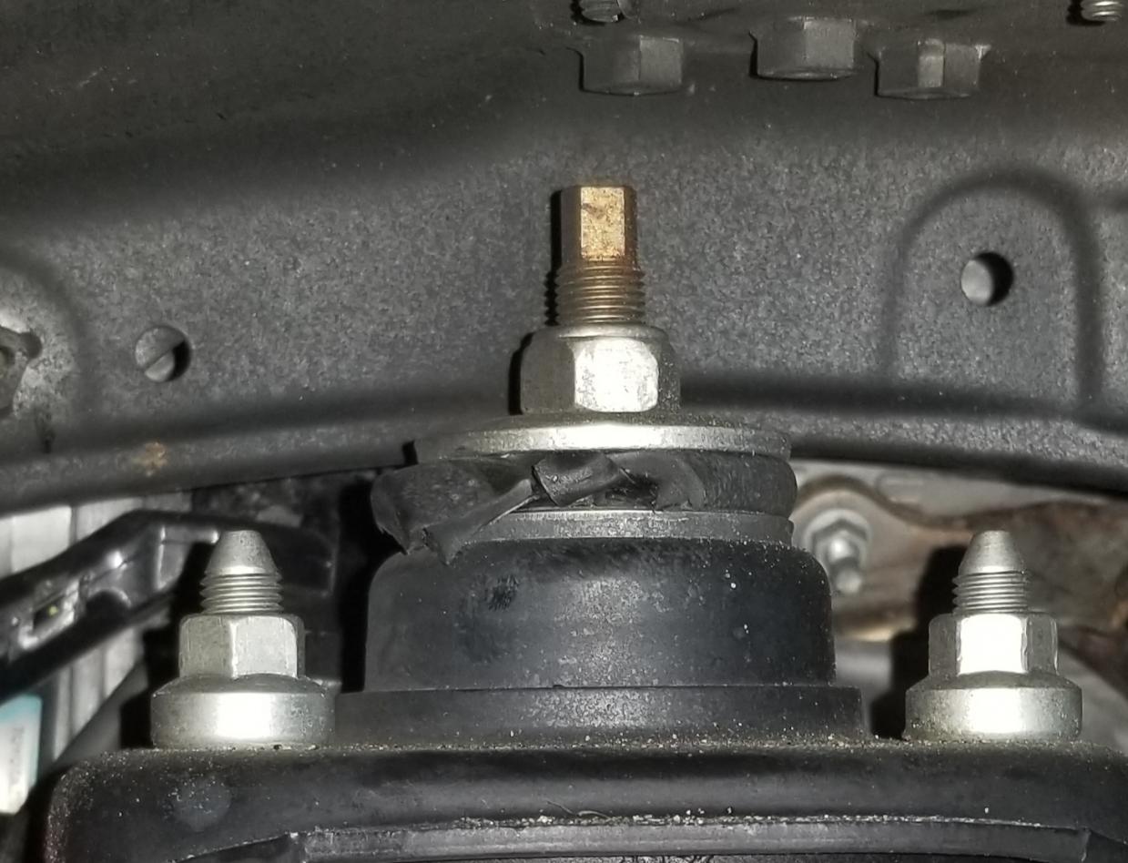

Chasing the same noise. Found the rubber shock bushings are failing, but not convinced the upper strut mounts(top hats) dont need replacing. Should have some new bushings in a few days, if that doesn't work... pulling the struts for a good inspection.
This is the worst one out of the 4 shocks. Pulled it and replaced it with one from the "help section". The one i removed felt almost like hard plastic. Loosened the other side thinking they are over torqued and now have the noise on that side also. Stock and poly bushings are in the mail.
