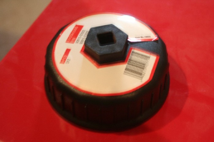

What kind of wrench are you using? At first I had the metal collar/band type but I found it slipped alot. I bought a socket type that fits the end of the filter (like a large socket) and works on a 3/8" ratchet. Good luck.

filter socket
i had trouble on my 06, tried a craftsman strap wrench and about 3 different filter wrenches, i bought a socket for toyota filters(labelled right on the package) for about $4 or $5 at autozone or advance auto parts and it came right off.

Here's a pic of the socket I talked about earlier. It is an item #10609 from Flotool, USA (cheap at Canadian Tire.)
