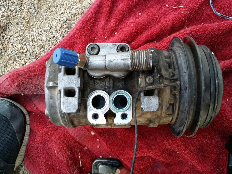

My compressor has major leak, so I hop online and found a reman for 1989 22re 4Runner.
It arrived today and as I'm about to swap them I notice they are completely different! :pout:
The leaky unit has two individual small manifolds (high, low)
Markings on the unit:
K191
T17
D D
S S
NipponDenso 047300-2000
12V 3H
Thanks for your help
Pic :high5:
How would I find a new/used compressor like this?
Like what vehicle uses these?
I ordered 1989 4runner and its not the same.
I ran into this problem once before also.
i cant remember the details of the situation tho. i have an 85, but the one i got looked like the pic above, and was wrong for my application. i believe it was from a newer model, early 90's perhaps.
i think you will have to get a pic of the unit before having it shipped. if you are ordering from somewhere.
Pulled a compressor out of a 85 Cressida that matches the pic. Installed it and ends up leaking from rear where the round plate meets the body. Model number varied but fit.
Think I have a pinhole in the high side line as well.
