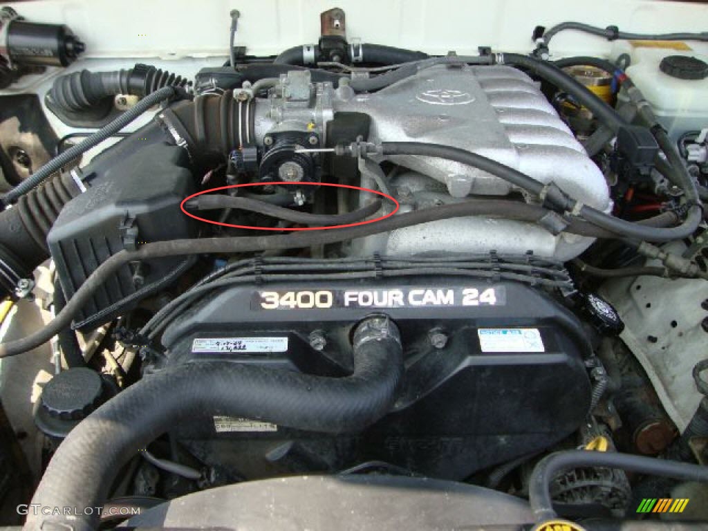

I have a 2000 SR5 and need help identifying the hose circled in red in this picture. I've gone through several parts diagrams and could not find the part number for this hose in any of them.

Should be:
17343B HOSE, NO.3(FOR IDLE-UP)
17343-62090 (11/1995 - 06/1998) 1 $14.39
17343-62110 (07/1998 - ) 1 $20.88
It is actually the vacuum line to the FPR, even though it is called something else. Any correctly sized vacuum line should be fine there...
-Charlie
The end that goes into the silencer tank has a larger inner diameter than the other end that goes into the steel hose.
Probably can run 2 different inner diameter hose with an adapter in between the two.
I opted to just get another Toyota parts hose 17343-62110 :smile:
Thank you, you guys are awesome!! I just placed the order for a new one from ToyotaPartsDeal.com as they had the best overall price (part + shipping) I found.
