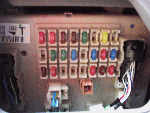

Ok, I got my mirror and all the necessary wiring and gadgets but no directions. I did print out the Toyota Gentex installation instructions that someone posted on my prior post but I 1) don't know how to connect the wires to the red things that appears to be some type of fuse 2) which slot in the fuse box to put them in . I am trying to post pics and I will ASAP as they are too big right now. I am resizing them. I am installing this on an 05 4Runner SE. Any help would be greatly appreciated. Thanks.
Pic of fuse box...

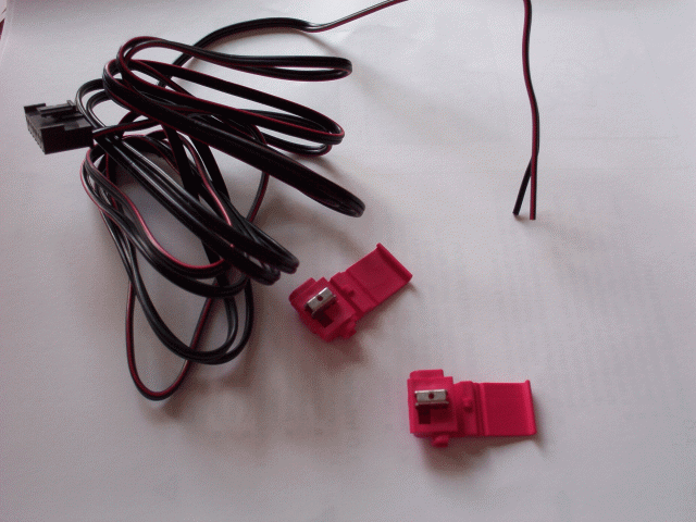

And the pic of the wiring and red doohickies they gave me but unsure what to do with them.

I dont have a clue about installing the miiror, but those red things look like scotchlocks......if they are, they're used to splice into the wiring. lay the wires you want to connect side by side then close the connector. don't know how reliable they are, but when i installed the oem fog kit in my previous 02 sr5, the kit came with blue scotchlocks to tap into the harness.
Thanks for the reply. I just figured that out myself also. I am assuming that I have to tap into some wiring in the vehicel which is 12v that goes is on only when he ignition is on also. I thought that someone installed this putting a fuse on the end of it and then routing it to the fuse box. No? Anyone?
