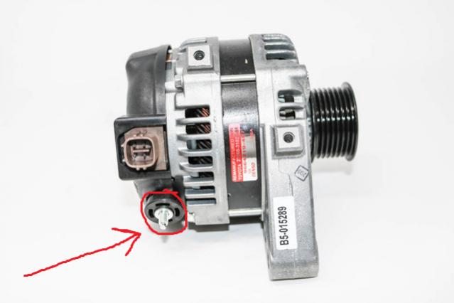

I have a 2003 4runner SR5 v6. I lost the nut that screws down on the post on my alternator while doing wire upgrades. Its a small nut with a flared side.
Can anyone help me find this part number? Its a 10mm nut but i cant find a replacement on toyotapartdeal.com or any other toyota parts dealer.

I cant exactly take out my alternator to find a nut that fits the B post threading. Im asking for someone that might KNOW what the 10mm nut size is so i can go to a store and buy the right metric flare nut.

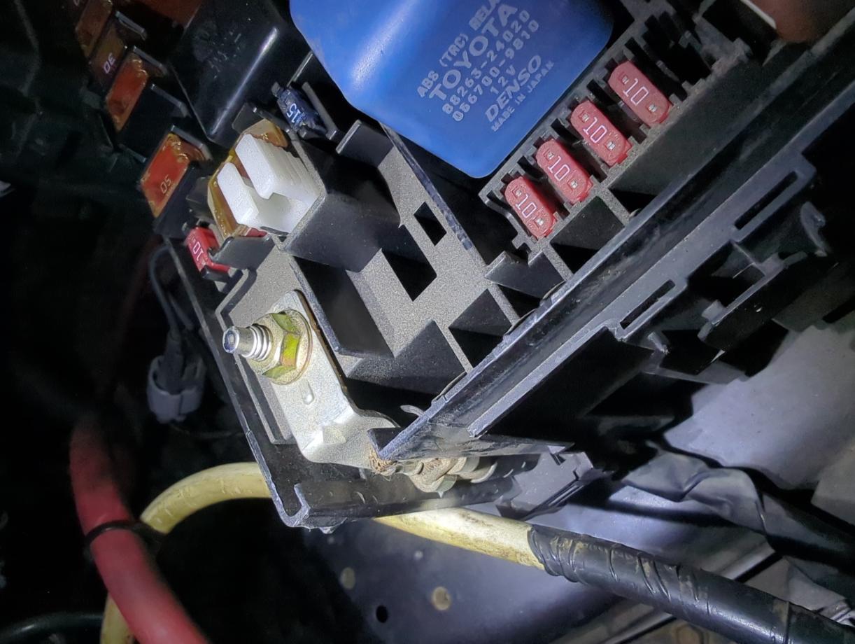

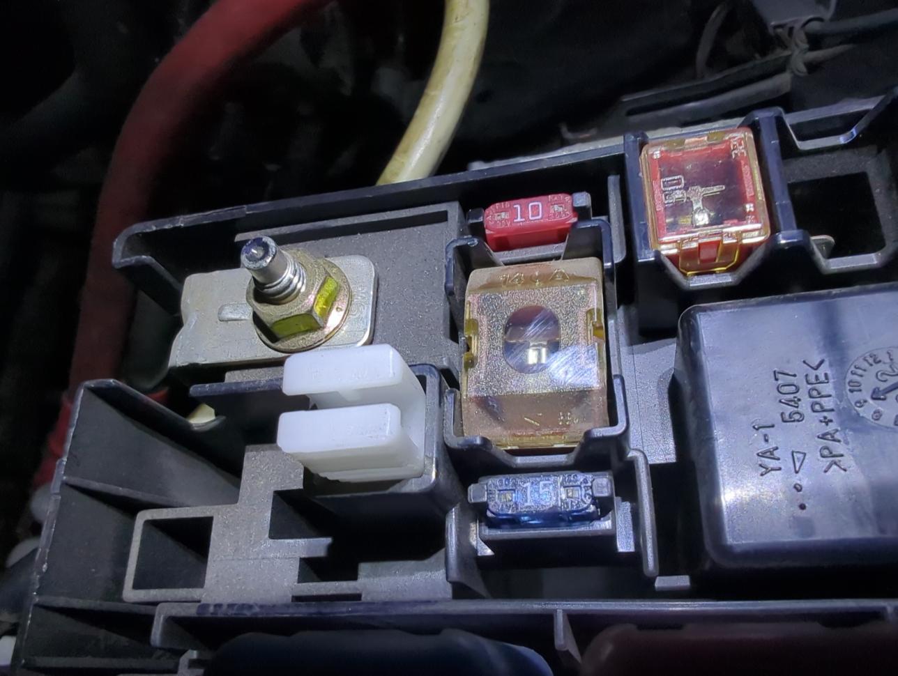

So I found that under the hood in the fuse panel, take off the lid and look at the 140 amp alternator fuse, that nut holding down the white B+ cable (with a black loom sleeve) is the same identical nut that's on the alternator. Same threaded post. Same exact nut size. Of course I cant use that nut but one can use that for reference.
6mm x 1.0 thread, like every nut and bolt requiring a 10mm wrench/socket on a Toyota.
