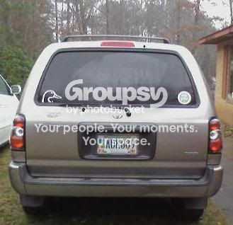

here is a picture of the new tails

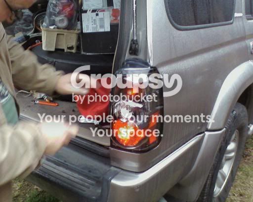

my dad putting them on..

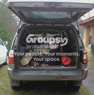

before and after
