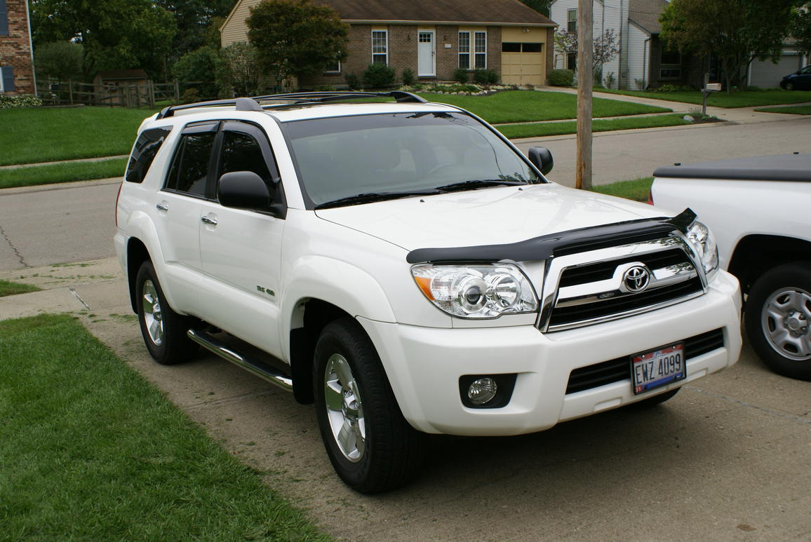

Heres a recent picture of mine taken yesterday. I put in the hood protector, window gutters, and SS Chrome Nerf bars. I also undercoated the whole rig this weekend. Best regards, Doug
