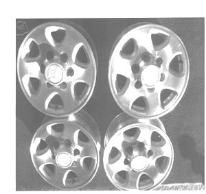

I'd like to pick the collective brains of those out there who know more about Tacoma/4Runner Chou Seiki alloys than I do. I installed a set of 15x7 alloys on my '93 4WD 4Runner w/auto hubs from a '98 2WD 4Runner. The problem: the center caps on front are too shallow and don't fit. The size stamped inside the '98 2WD wheel is J15x7JJ. I noted a '96-'98 4WD Tacoma today w/ alloys that had T15x7JJ stamped inside. A different wheel for 4WD vs 2WD? I inquired at Desert Toyota here in Tucson but they were useless - no help at all. Does anyone know if a deeper 4WD center cap exists? Should I modify/cut out the center? All recommendations welcome...

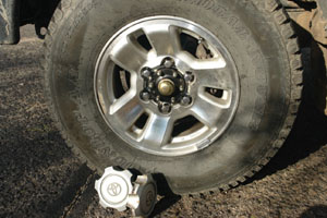

These T100 center caps will fit your wheels. You can order them from the dealer........Sorry for the poor pic quality

I checked out T100 caps - even non-oem caps were $80 a pair!!! Soooo, I used a 1 3/4 hole saw to cut a nice clean hole in the front caps which clear the dust cover nicely, but the six bolts in the hub (surrounding the dust cap) still prevent the cap from snapping completely into place. I guess spacers are the next step. I was thinking 1/4". Never used them before. Any suggestions?

Hey, I think your advice was good - it worked for you. I think spacers will do it, just never used them. Not sure what size, brand, the best place to get them, price, etc??? Are they a good idea? Anyone???
What you can do is change out the six acorn hub nuts for standard auto grade hex nuts. That should shave of about 1/4 of an inch. On my manuals I did that as it's OEM to run open hex huts on the 6 hub bolts. You will need 12 in all, It's worth a try, since youve gone this far.
That did it!
Duh... why didn't I think of that? Took all of five minutes to change them out and the caps fit!
