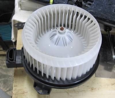

Since most of the insulation was wet under the fan motor I removed the fan motor and found some water. There were a few drops that came out with the screws and a little more sitting inside the fan motor itself. Also when I removed the floor mat it was hot and wet on the back side. This seems like the exact same problem we had on our Sienna with the AC leaking.

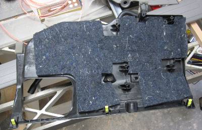

Well I finally got the carpet dried out. The carpet pad they use stays wet forever. I rolled back the passenger carpet and had a fan blowing on it for about 6 hours before it dried out. The padding under the blower housing was soaking wet also so I took this piece and placed it in front of a fan. Here is a pic of the trim panel:
The padding on this panel was soaking wet. This is what was dripping. When the fan or AC was running water was dripping from the padding in the upper left corner. I saw a few drips from the right side also, but just a few. My guess is that once this padding got wet enough it started dripping where I could see it.

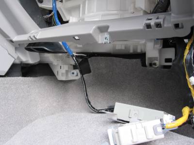

So how did it get wet? This panel is mounted below the motor housing and above the drain line. See pic:

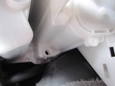

The AC drain line runs below this panel so the evaporator tank would have to fill up with enough water to back up into the motor and then spill out around the motor to get the panel wet. When I pulled this apart I did not find any water inside. Also, see the 4x4 controller sitting on my carpet, the top of this unit was wet and this is on the far right side away from the evaporator tank. My AC drain line was clear so I pulled it out and took a look inside the evaporator tank.
You can’t see via the pic, but the only thing in there was 1 dead fly. It was clean and had no water build up. When I reconnected the line and ran the fan, I could feel air blowing out the drain line so I have rule this out as a possible cause.
