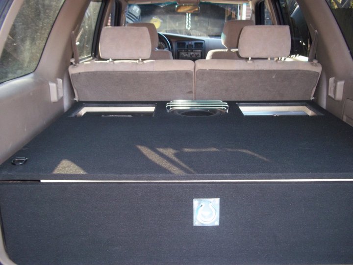

Here's a pic of my set up DLS RA40 amp bridged to 200 watts x2 for the front Boston Acoustics comp, cadence Audio ZRS 1502 Bridged mono 600 watts for my Boston Acoustics G3 10 sub Kenwood HU nothing special the single 10 in the right box hits HARD everything about $1200 of the net. Don't forget that your system is only as good as the wires. 215371_139925216079675_100001865913566_264520_823111_n[1].jpg
