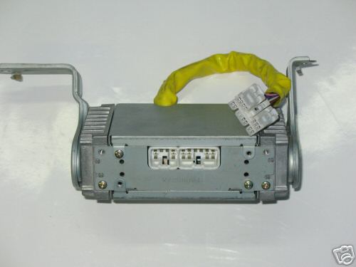

If it looks like the picture below, I've got several. And I can beat Ebays price all day long!
Okay, it does look similar to that, but I'm only going from memory.
Where did your amps come from? Are you sure they'll fit my 4Runner? Do you have any specs on them?
How much are you asking?
$20 + shipping, and mine are guarenteed to work!
Mine came from various cars... Mostly 4runners! When we do deck installs we generally pull everything out and a lot of our customers say keep everything...
Toyota is known for using a lot of the same product in every vehicle. This one should work, it just has those brackets mounted on the side which can be taken off.

Okay, I'll probably take it. I just want to make sure that it's the same unit that I'm using now. Maybe I can peek up under my dash to get a look at my amp.
Hey, is there any way you can check on the power of your amp or amps? Maybe Toyota made analog amps with different ratings? If I'm going to replace my amp, maybe I should get one with a bit more juice!
