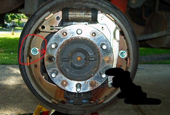

So this is super random and may not be your issue, but it was for me...I had a similar noise and it was really annoying. Turns out the hardware for the e-brake in the rear was messed up and was causing the spring (which is circled in red) to contact the back of axle shaft flange. I bought new hardware and then swapped in a new spring along with the multi-bend shaft that goes through it. The shaft had been rusted out a bit and had weakened it enough to be able to flex because of the spring pressure...the arrow is pointing to the area where the rubbing was happening

No problem, and for reference, that system is a ***** and a half to get back together. If you're not mechanically inclined I would highly suggest you taking it somewhere to get that done (if in fact that is the piece causing the noise). The reason I found out that that piece was making noise was, I had someone drive the car while I jogged beside it to listen and better pinpoint the noise. After I was sure it was the rear passenger side tire area, I put it on jack stands and started pulling stuff off. Once I had all the wheels off the ground (mine is AWD) I started it up and put it into gear with the tire off to see what part was contacting
