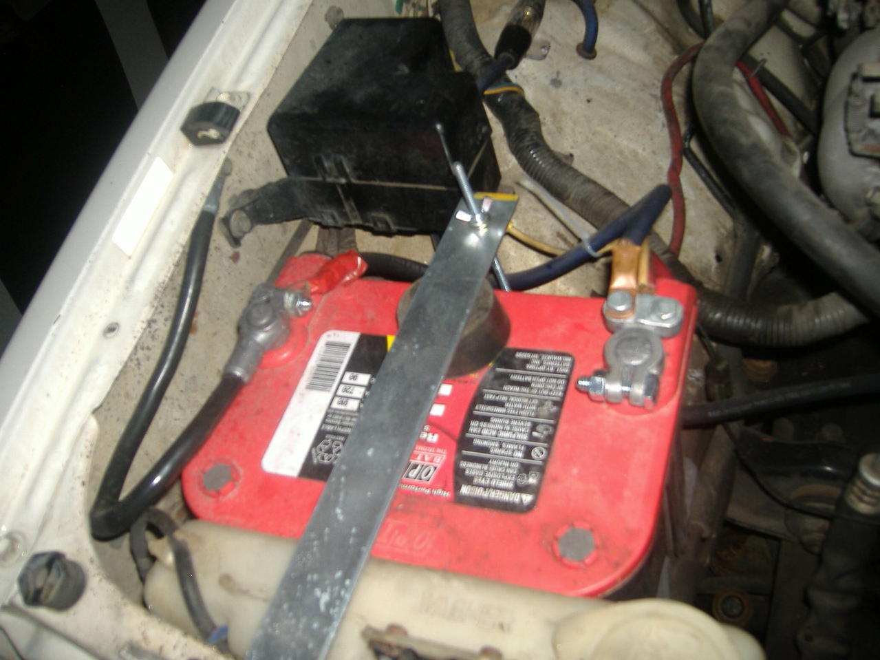

Dunno if the gen2 is similar to the gen1 there, but I couldn't find one that fit right for my '86 at NAPA, Autozone, or Checker. They're available on Ebay for about $25... I decided to make my own for about $10. A chunk of flat steel, a threaded rod bent into a hook at the bottom, a wingnut, a lockwasher, and a chunk of rubber I had laying around.
