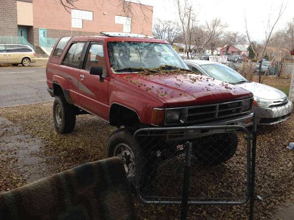

I have an 89 4runner and I need new shocks, front and back, only problem is that it has an 8 inch lift on it. So im looking for something that would still be good but wont make me go broke
You need to find out what kind of lift. Im guessing its a 3" body and a 4-5" drop bracket.
Update: so the guy i bought i from says he thinks its a 4"
heres a picture if that helps

I think that's higher than four inches, but it's hard to tell. You need to measure the distance between the shock mounts at rest, fully extended/drooped, and fully compressed (bumpstops squished). I wouldn't just measure the current shocks, because who knows if they're correct?
So I checked it out, im pretty sure that it has a 4" transmission lift along with a 2" body lift, but i also noticed it looks like the frame is actually denting the shocks when it fully compresses, any ideas?
