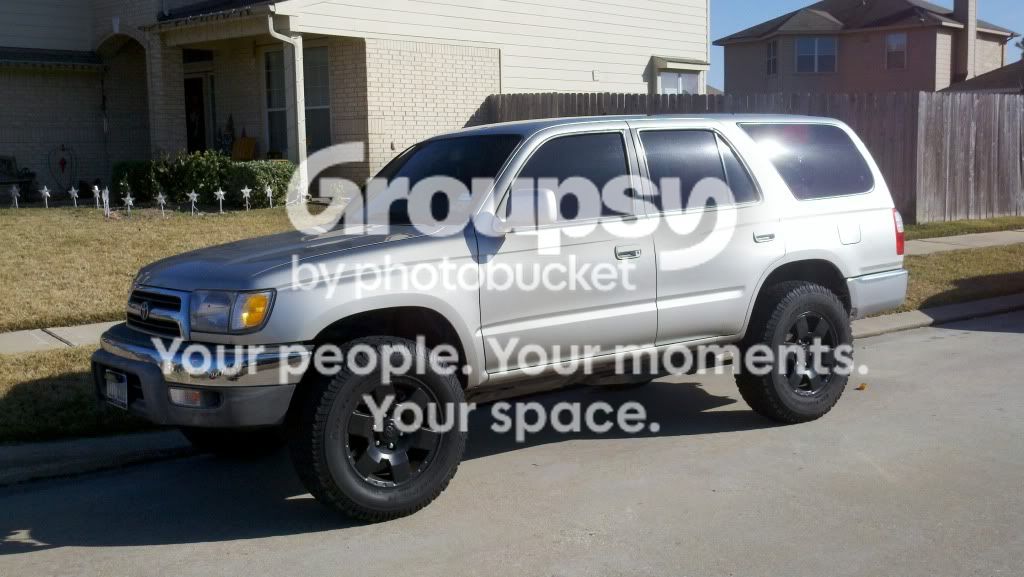

I need upper arms cause they are the ext travel shock and if I take it wheeling it will bind the upper ball joint cause it droops out more than the factory shock. Here is a pic of my 4runner with them on but I have them set at stock height.

Yeah, I dont know anyone else that has mentioned running the Icons, I dont have a strong opinion on em cuz I dont know anything about em.
