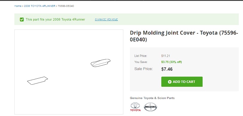

Here they are Seymore.
8pcs - Part# 90119-08C47 (roof bolts w/ rubber washers)
4pcs - Part# 63185-42020 (roof brackets w/ foam pads - TE already have this under the installed roof rack)
4pcs - Part# 75596-35030 (roof plastic covers)
It looks like it changed the numbers I put in to the part number 75596-0E040. I only tried the last part #.
4runner .org forum post and pics by W8kbrder I got the numbers from. DIY: Roof Rack Delete (w/ pics)
Those are the numbers. I input your 08 sr5 in and it said it fits. see pic.
CAUTION !!! I have never ordered from this source and do not have an opinion of them.
OEM Part Source | Genuine Toyota, Honda, GM, VW Parts and Accessories.
