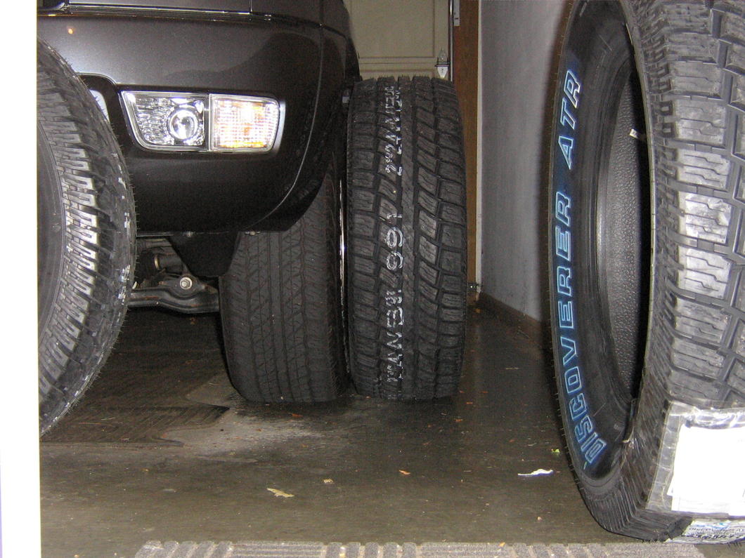

You sound like you'd be happy with my setup. I just lifted the front one inch with a simple Cornfed spacer kit (very inexpensive) and got a set of Discover ATR tires. Looks better with the lift and the nice tires, plus it's a beast in the snow. The ATRs are almost a hidden treasure when it comes to street-oriented all-terrain tires. I found out about them because a lot of plow guys use them on their pick-ups around here. I figured they must be on to something if they are all using them to plow snow, so I figured what the hell, I might as well try 'em out. Best tire decision ever. They are great all around tires and work really good in snow, 100 times better than the Dunlops that came on my 4Runner.
Here's a pic before I had them mounted

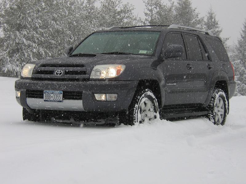

Jed-Show us a side profile of the truck please!
Thanks and have a good night...
Well, here's one I took in the snow today. It may be hard to tell in this picture, but the front has a 1" spacer lift and the tires are Discoverer ATRs.
