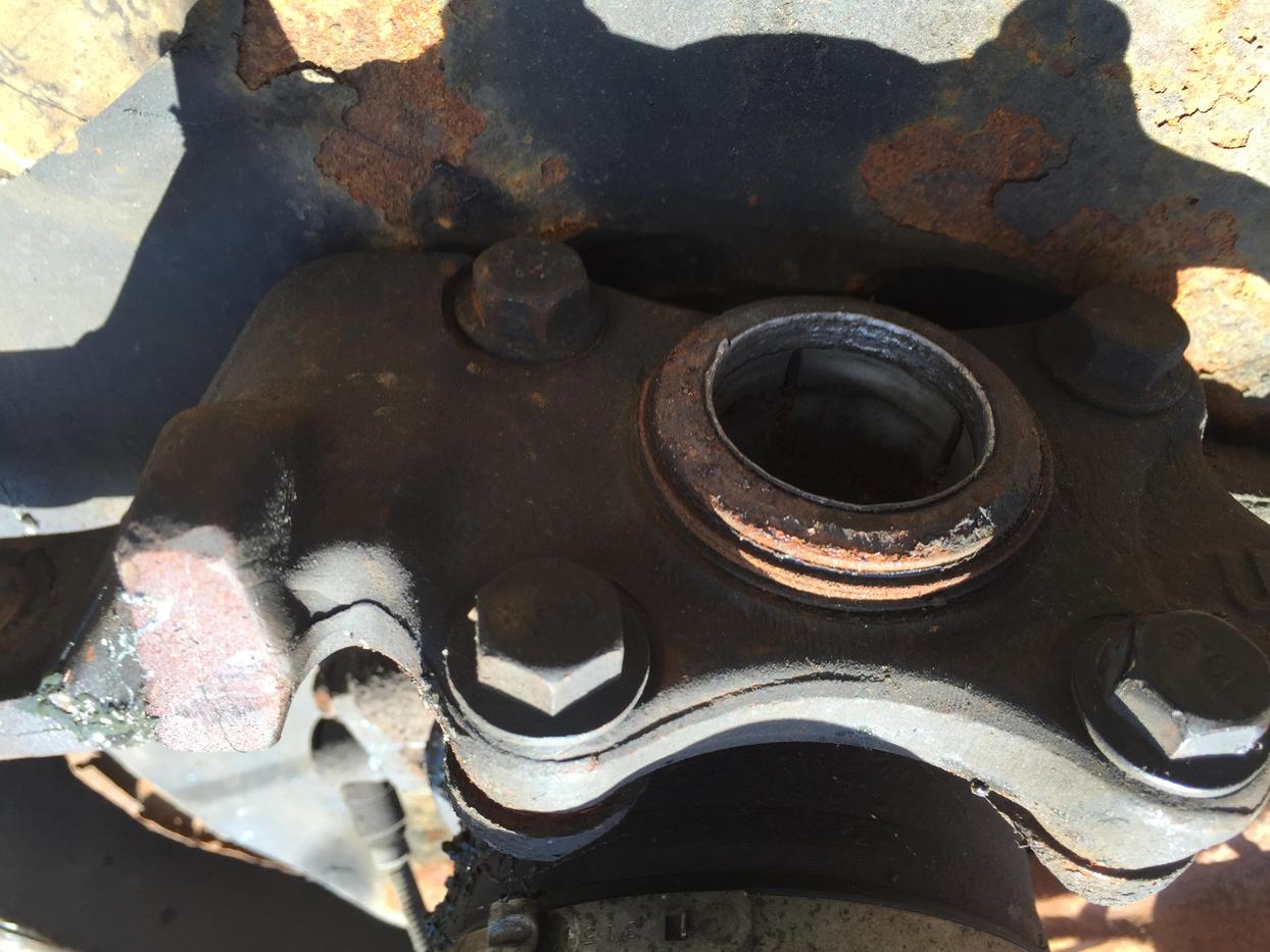

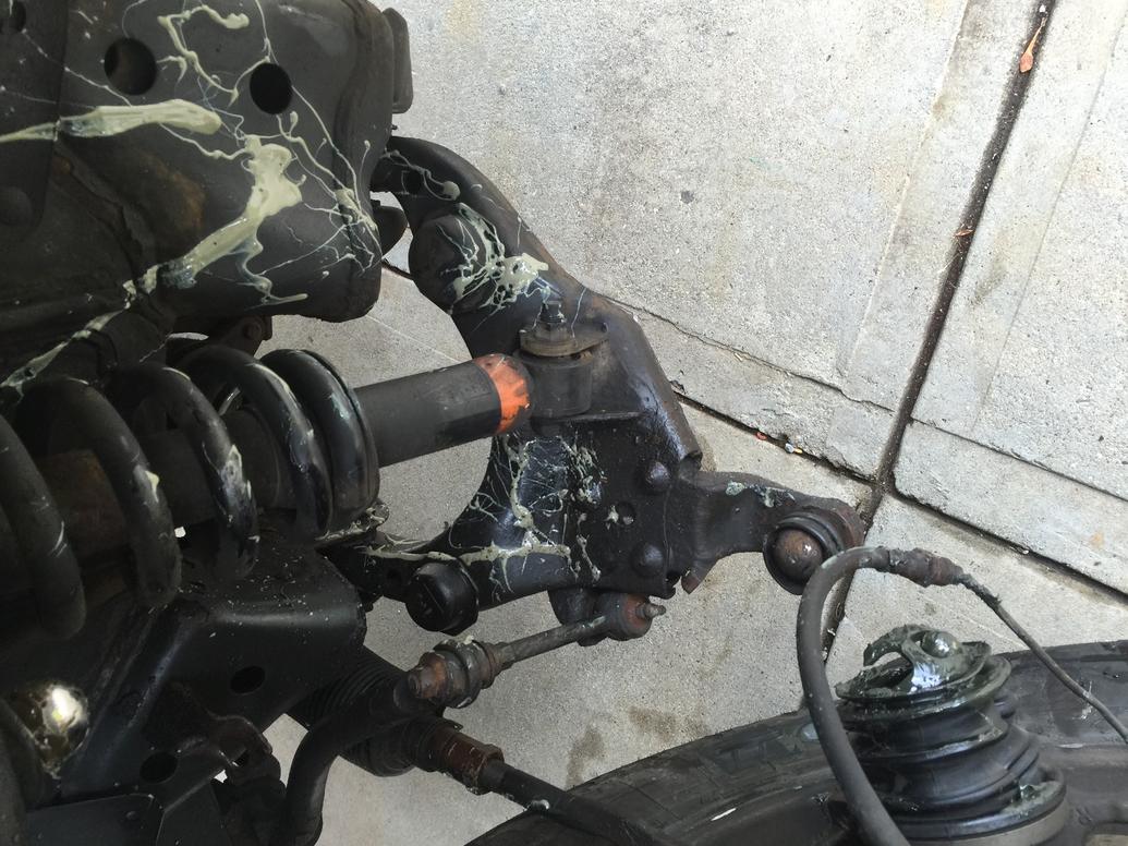

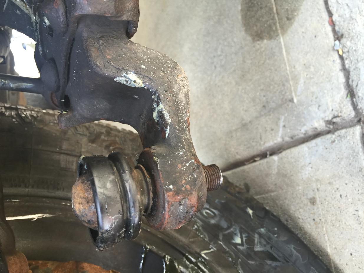

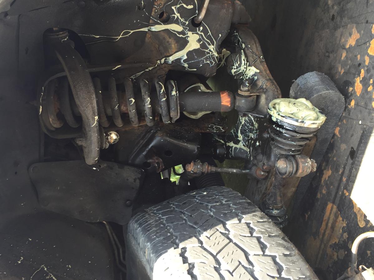

Hi guys,
I recently had an lbj failure on my '00 runner which had me skidding to a stop in them middle of the street on nothing but the side of my tire. Tore out the ubj as well as axel and the other normal problems experienced. These ball joints were Moog and were just purchased in November of '15, so they had not been on even 7 months. there are obvious signs that show it was a lbj failure. i also replaced inner/ outer tie rods at the same time as the lbj. I have contacted Moog who told me to contact rock auto. this has been just a run around as they now just want me to submit a claim online.
I was wondering if anyone had any experience with such a problem and how it was resolved. I am tempted to get a donor car since my '00 and '02 4 runner both need parts cosmetically as well as random other parts needed. I have attached a picture of the damage here as well.
Thanks!

Here are some better pictures of the failed LBJ
