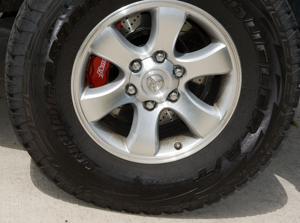

Read somewhere, maybe on this forum, that Tundra brakes would work. As mentioned, Steel brake lines, fluid change, etc. should help. Wish I'd known before going with BBK. I do a lot of mountain driving so wanted something beyond stock.
