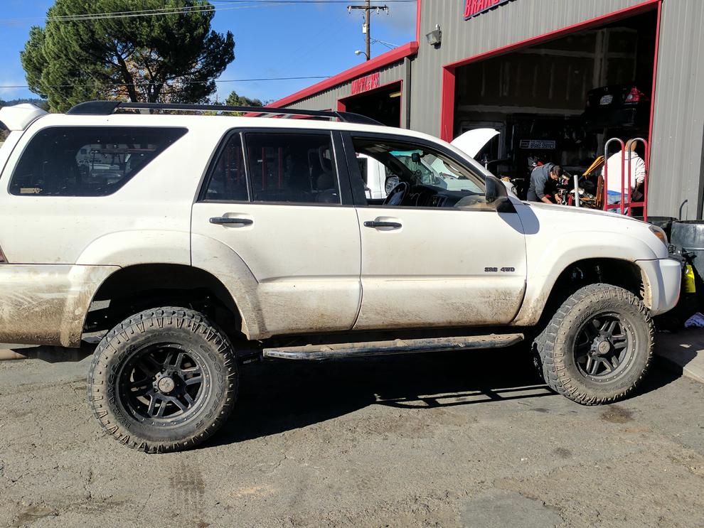

Just came down to the shop and this is how shes sitting now. There is also no spare in the back and I don't think any gear back there.

Don't go with the spacers on the coilovers. You'll be more likely to bind a cv axle as opposed to cranking the coilovers up. Crank the coilovers up some to gain more front lift. I'm probably at 3.5" front lift with my icon coilovers. I have a diff drop and never had an issue with it.
The rear will settle. I have the same setup minus the cdcv, but only a 1" body lift. In the rear I am running metaltechs hd long travel coils. With a 1.5" spacer on the rear drivers coil to level the truck. But have to have the front left coilover cranked more than the front right to help level things out more.
You might find if they have adjusted the rear trackbar to center the rear axle that the driveshaft will hit the gas tank skid at full droop. I found for the adjustable track bar and links they worked best at the length that matches stock.
