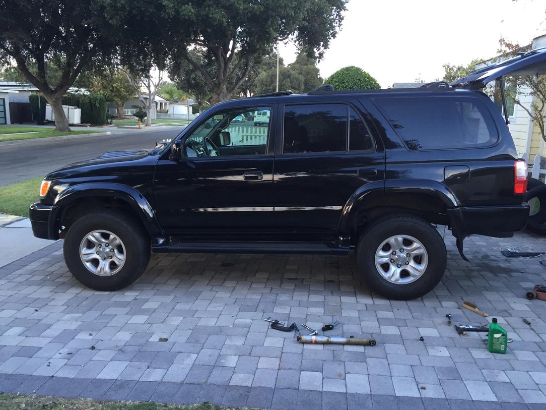

So I just finished lifting my 4Runner, tundra coils/ome 890 and 5100 bilstein. I disconnected the rear swaybar at the 2 brackets connected to the rear axle (because the end links were badly rusted) I lost a bracket and need another one. Can someone point me in the right direction? New? Used? Part number...

Get Energy Suspension Greasable Mounts. They come in sets of 2.
Front P/N: 9.5161 (G or R)
Rear P/N: 9.5156 (G or R)
The letter at the end of the Part Number is the color of the bushing. G for Black, R for Red.
