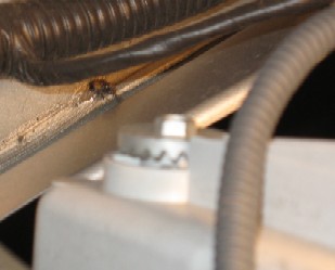

Usuaually there is a screw you turn on the housing.... don't know if the 4runner works the same or not.
rra640 said:
Do you know how to adjust them??
look for this funky "knob" with the small nut and serrated wheel
