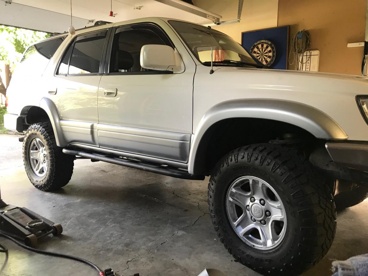

So I got the Superflex springs in there
Before with 4 year old 890’s I was at 22.5
Now with superflex I’m at 23.25 driver. 23.5 passenger. Yesterday when I installed them I was at 24. Both sides before a fill up.
That’s quite a bit of settling in 24 hours?? I hope they don’t settle any more. I was hoping both sides would end up at 23.5 or more.
Oh. And these were a pain to get in. The 890 came right out. I had to get a compressor to get these in.

post install / settling pic. 23.5 RR / 22.5 FR.
I think i want 285's now. lol
