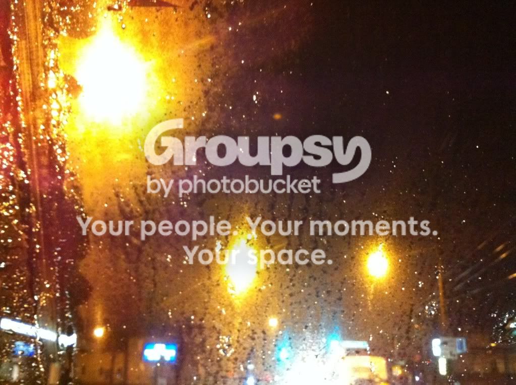

This was the view out of my windshield last night in the rain. That haze you see with the streaks in it is an invincible film seemingly chemically bonded to the glass, streaks and all. I have had this problem with various vehicles, including both my 4Runners. I have read tons of stuff online and in forums, talked to glass guys, body shop guys, and though there are tons of theories and remedies, nothing seems to work.

Also, to elaborate on the picture, those runny streak marks are clearspots in the haze. I just drove home in the rain again. It was a nightmare, I could barely see a thing with the glare from headlights and streetlights through this stuff. Its almost better with the wipers off.

After another vigorous round of various solvents, spirits, strippers and steel wool, I started going at the windshield with rubbing compound. As I was doing this, my neighbor's friend came by. He happens to own a hand car wash/ detailing place in the neighborhood. I never thought to ask him about it because of previous experiences with other professionals. So I showed him the picture, and he immediately told me he sees it a lot- its the residue from the stuff they use in automatic car washes. He said that's one of the reasons he owns a hand car wash.
He said what I was doing by hand with the rubbing compound is the same thing he does with his machine. Compounds the stuff right off the windshield! Lo and behold, after I compounded the windshield like four or five times with a lot of elbow grease, I couldn't see any of the stuff anymore. Before the compound a damp paper towel would bring the crap right out. Not anymore! Plus the water sheets off the windshield now instead of beading into tiny greasy droplets. I rinsed everything really well and cleaned the windows with Invisible Glass.
