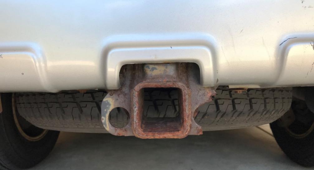

I have a 2004 V6 4Runner. Had to modify my OEM trailer hitch to accommodate UHaul ball. Now I want to replace it with the V-8 hitch. My bumper has the trailer hitch notch so I think I can use the V-8 trailer hitch. Can I do that? I know nothing about towing but I'm relocating from PA to SC and will doing lost of towing.
Thanks

I did just this on my 2007. I don't think the 2004 should be different. You may have difficulty putting your hands on an original Toyota 4runner v8 hitch, and might want to consider an aftermarket one.
If you find an aftermarket hitch, I’d suggest you find one that fits only your 4Runner.
Some hitches fit multiple vehicles via a virtual jigsaw puzzle of extra parts, only a few are used for any application. They usually cost less because they fit more vehicles, not all from the same brand. And sometimes they don’t fit what they say they do.
I had this experience on my 2002 Tacoma TRD 4x4. It was not equipped with the factory tow package. I later bought an aftermarket hitch. The hitch manufacturer’s website, a chain auto parts store’s computer system and their counter person said it fit my truck, several Jeeps, and GM trucks. When it came, I found nothing on the box nor the instructions that it fit a Tacoma. And box was filled with lots of parts.
I returned the hitch and ordered one that fit only my Tacoma. It cost more money. When it came, I found only one part - a welded hitch assembly. It fit perfectly and went on easily. And I assume a lot more sturdy since it was one piece, not a bolted together jigsaw puzzle.
I don’t know if that generation of Tacoma and 4Runner use the same factory hitch assembly, but if they do and you go aftermarket, I’d suggest you go with one that only fits your 4Runner, and not a dozen other makes and models.
I would add that a good used hitch from a car that's not in the rust belt would be just about as good as a new one. Might need a little paint if you want it to look good but functionally it would be just as good. I'd try a few salvage yards. Should be markedly cheaper.
For 03/04 they only seem to list the type of hitch you already have, #35 at the link below. 05 and up seem to be p/n PT228-89460. Not sure if that would bolt up though assuming you can find one. There does seem to be some places that show that p/n in stock plus there's some new ones on ebay.
E-trailer would probably be easier as you know it will fit. If you do go with a frame mount one make sure you use a thread cleaner for any existing threaded sections of the frame.

I'm a big fan of Curt Manufacturing.
The part number you're looking for is 13445 (Amazon has it for $204) but look at Class 3 Trailer Hitch with 2" Receiver SKU #13445 for $251.08 by CURT Manufacturing

None of the dealers list the 2003/2004 V8 hitch assembly any longer, it had a different part number than the one you posted for the later years 4th Gens, I have the part number stored somewhere on my computer but I can't seem to find it.
I would think the later model would fit though even if one would have to redrill some holes in the frame or it may bolt in just fine, it's that way on mnay parts for 4th gens where they changed the part for later year models.
There's is a 2004 OEM V8 hitch on eBay right now for $150, but it is missing some of the minor parts, there are some shims that fit between the frame and the hitch and also shims for where the center section bolts up that aren't there, but you most likely really don't need the shims, it's in Virginia, here's a link to the listing
2004 Toyota 4Runner Trailer Tow Hitch used | eBay
Just an FYI, the OEM V8 hitch is a Class IV hitch, the Curt class 3 hitch posted above is only rated to 5000 Lb, some other brand class 3 are rated at 6000 lbs most class IV hitches and definitely the OEM V8 hitch is rated at least 7000 Lbs.
And I thought that replacing the hitch would be simple. The part number I got PT228-89440 is suppose to be 2005 part for V6 and V8 PT228-89440 - Tow Hitch - 2005 Toyota 4Runner | Boch Toyota South. I'll probably have the dealer install it. I considered buying a newer 4Runner but the price is way out there. Since I'm the original owner and no problems with the car, I might as well invest in the 4Runner and give it more life.
Interesting, they listed both v6 & v8 for the one I posted above. Makes you wonder if the early one was a different vendor or something.
Maybe this is the correct one? 2004 Toyota 4Runner Towing Options, Tow Hitch. UlCLASS, Exterior, Class - PT22889440 - Genuine Toyota Accessory

That seems to be the correct part for a 2003/2004/2005, it's the same part number posted by the OP in post number 11 above and the price is $112 less for that dealer which is up north in Massachusetts and hopefully close enough he can pick it up and save on shipping, really depends on where in he is Pa. he is, but I doubt the shipping would be $112 with the dealer's rate, but the only way to know is the go through the ordering process to see the shipping cost.
Called several Toyota dealers and finally found out is that if my 4Runner hadn't come with a factory hitch, the recommended hitch is PT228-8940 (the frame hitch) but since my 4Runner had a factory hitch and the bumper has the notch, recommended hitch is 5190935011.

What they're selling you is the V6 hitch, it's what you have or had already, it's not the V8 heavy duty hitch, the one you want is the other part number you posted, it will work no matter what they are telling you!!

I could have given you mine, it went in the recycle bin. I pulled that off of my V6 and put on the factory V8 hitch. Found mine at a wrecking yard. They are hard to find, but I wouldn't hesitate to go aftermarket - frame mounted hitch.
