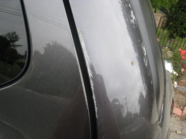

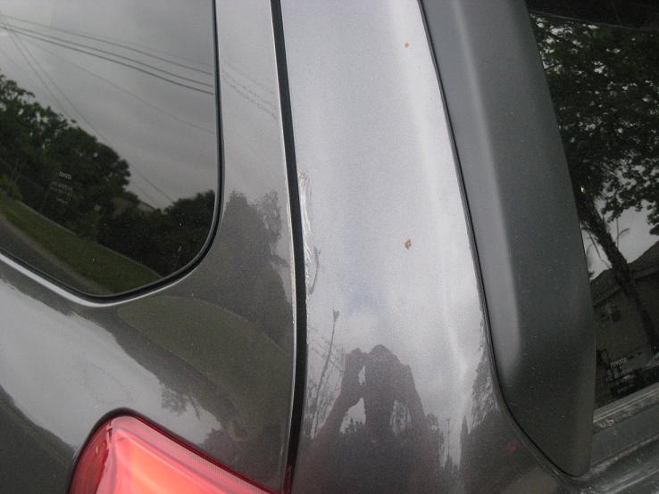

dumb parking gate at work decided to close on and scrape my car. In your opinion do you think it would be better if I took this into to shop or do you think I can tackled this on my own? The scrape is on edges of the left rear hatch and the car. All your opinions would be greatly appreciated. Thanx guys!

Is it down to the primer? If not, you can wipe it off with some elbow grease and rubbing compound. If it's down to the primer and because it's not a thin scrape (it's pretty wide), you should have it painted.

Do the fingernail test: if your fingernail gets hung up on the scratch then it's too deep to buff out. I first recommend touch up paint and https://www.langka.com/index.php. If that doesn't work, then take it to a good body shop.
If your fingernail doesn't get hung up on the scratch, then have it wet sanded and buffed. Or you could try ScratchX.

If it's not too deep, a good wash --> ScratchX buff --> polish --> carnauba wax seems to do the trick quite well.

the paint is down to the white part. I can see that the paint is chipped off of the car. I'm going to talk to my employer about it but some how I think they'll try to place the blame back on me. thanx for your advice guys.
