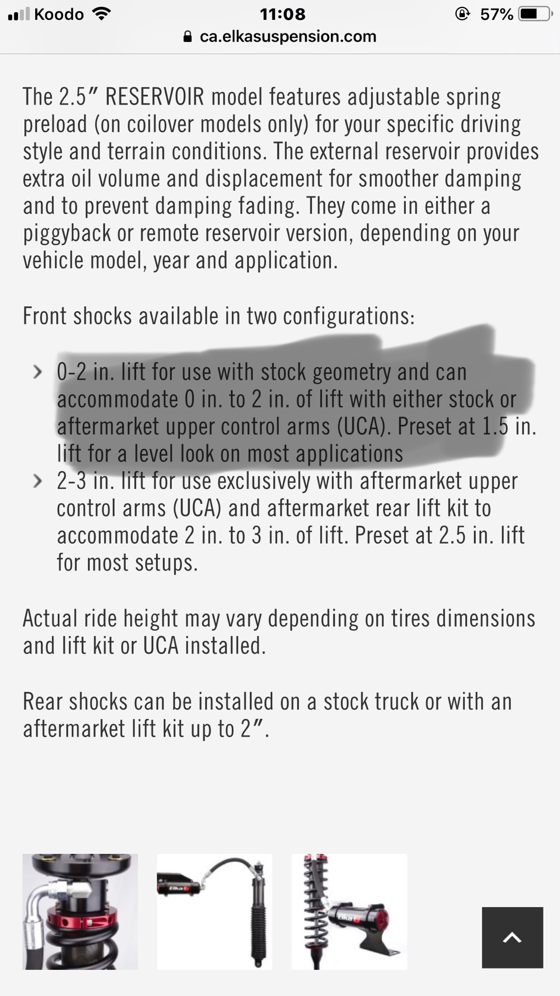

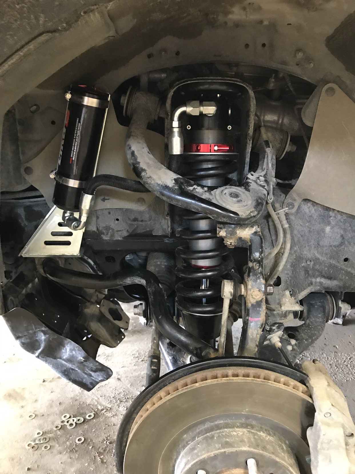

So I gained 3.6” of lift after installing the new suspension which I didn’t expect since according to owners manual,it should be 0-2” and my goal is to lift 1.5” with stock geometry.
What would you recommend ?
Should I reduce the preload(they are preset at 1.5” from the factory and it’s recommended)?
