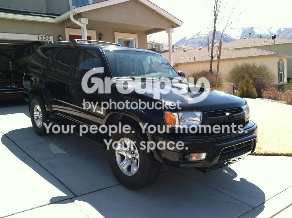

A little BIO, My grandma bought the 4runner Sports Edition 2wd 10 years ago new. It has been in a accident, but has been fixed, it doesn't even have the original chassis, but still the same 02 runner chassis. Last Year (Sept. 23) the runner has been passed down to me for my 16 Birthday and I love it.
Pics:
runner.jpg~original

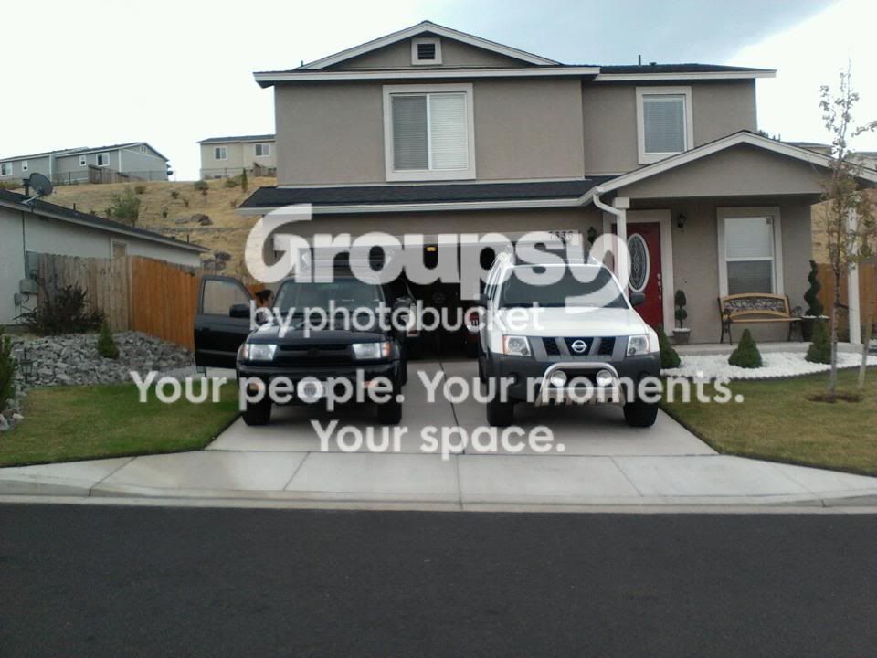

Next to my dads Xterra

I love your 4Runner man, super clean! As far as the lift goes, I think the '99 tall coils will lift '02's about two inches, so I would just go that route. As far as tires, I would get some 265/75/R16's (32's). Also check out the sticky's at the top of the forum. Plenty of good info there. Good luck and welcome to the forum!

Clean rig, I like it!
P.S. Nice Mustang in the garage.
