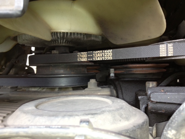

Does anyone notice something missing in the pulley pic? I found a broken belt lying on the front skid plate this morning. What does the missing belt go to?
Also, The oil that I drained was not milky and it didn't smoke upon startup. Could it be that the original owner thought it was a head gasket and it might just be a valve cover gasket? Is there a definitive way to tell if it is the head gasket?
Check your oil for coolant, and check your coolant for oil. A blown headgasket allows the two to mix, hence when you crank her up a ton of white smoke will billow out of the exhaust. A leakly valve cover gasket just leaks oil, usually onto the exhaust manifold and down.
Start with a compression test and a coolant system pressure test. With compression, consistency between cylinders is more important than the absolute number.
