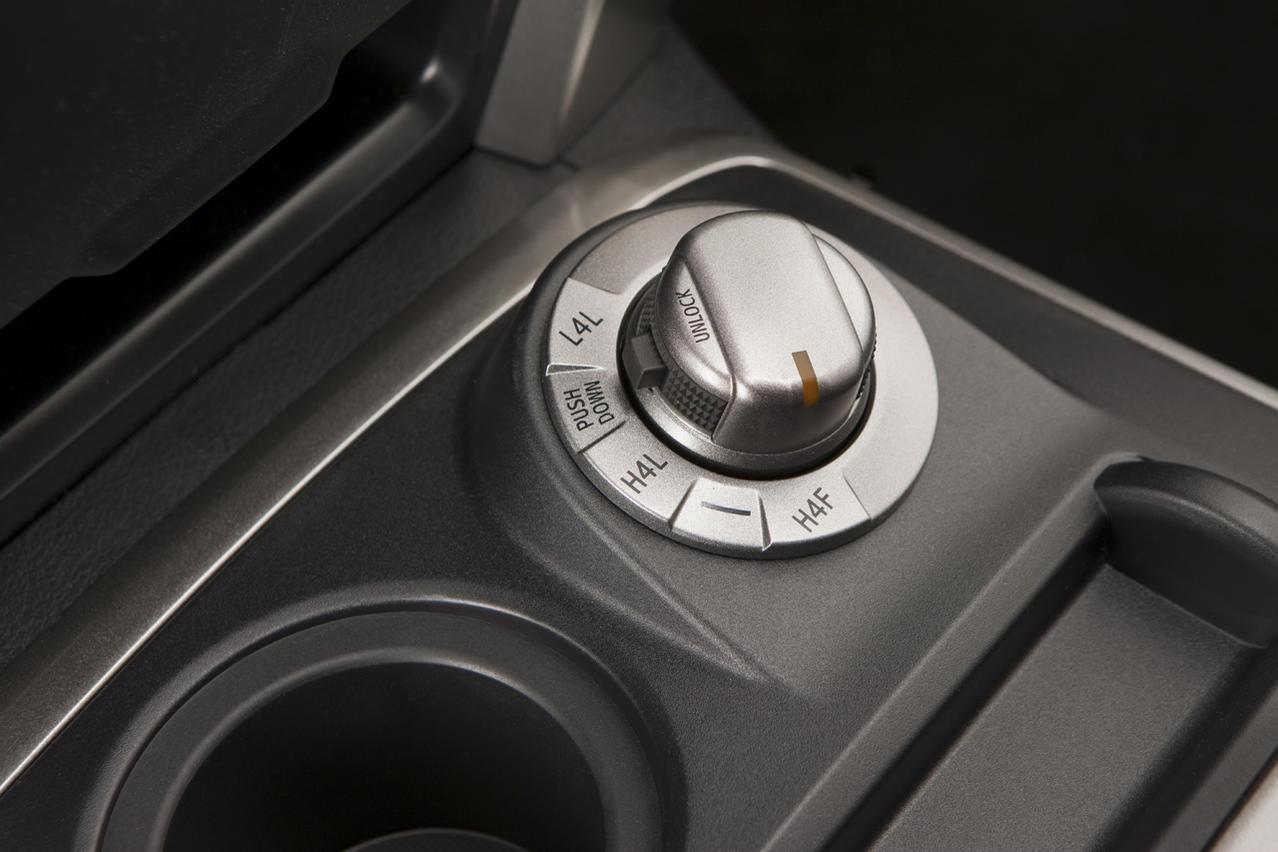

To get you started and put your mind at ease, the first thing to realize is that since you're getting the Limited which has full-time 4WD, you'll likely have very little need for the other two drive options. Now you can relax and take your time absorbing what the other options mean.
So, you've got 3 drive options -- 2 in hi range, 1 in lo range
Hi range
1. H4F- Full time 4WD (default)
2. H4L- Still 4WD but the center differential is locked.
Now it's not called full-time 4WD anymore because you're not supposed to use it all the time. On the SR5 and Trail this state is called part-time 4WD (on those models, it's the only 4WD hi option). It can present problems with tight turns on pavement. Best to use on surfaces more slippery than dry pavement. You'd use this only if you needed some extra 4WD capability -- really deep snow, etc.
Lo range
1. L4L- 4WD again, center diff is locked. Your tranmission still shifts through the gears (probably only thru 4th), but each one is much lower than before. You'd need this mostly for speed control on say a steep off-pavement hill -- up or down, or for slow speed over big rocks. Also, if the neighbor asks you to pull a stump from his front yard, this would be the drive option to use. :)

Actually, the Limited's 4WD system is more sophisticated. It is fulltime 4WD, with a limited slip center differential that is lockable. When the center diff is locked, it behaves just like a part-time 4WD in 4WD high. It also has a low-range.

In the 5th Gen, the SR5 and TE do not have the Torsen center diff, but are instead part-time systems. The Limited has the Torsen.
In the 4th Gen, they all had the Torsen center diff, but the V6 had an extra 2WD mode.
Hi range / low range has nothing to do with traction. It just reduces the gearing to give you tons more torque and engine braking.
It is only useful at very low speeds. It's mostly just for offroad situations. Going down hill you use it for engine braking, or crawling over rocks you use it for the increased torque.
If your just driving on the street you won't need it, but it is a good idea to know how and when to use it just incase. You also should use it every so often in your driveway or at a parking lot just to keep the linkages lubed and free.
