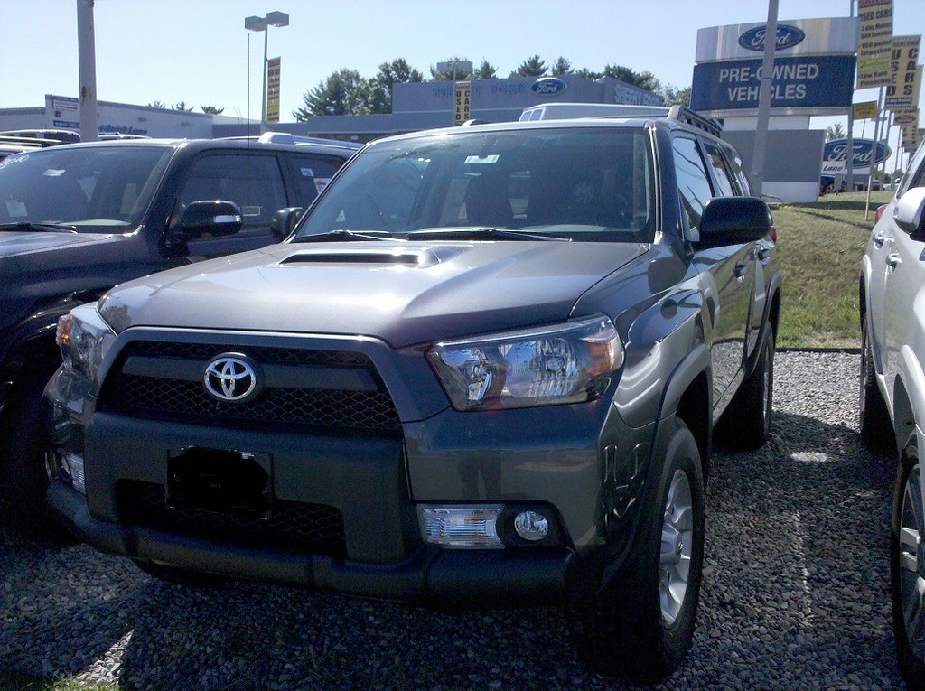

I just recently purchased a 2010 Mag Gray Trail and love it. My only concern as of late is what seems to be just poor low speed performance. Just checking to see if any 2010 owners have experienced strange erratic shifting only at low speed. I've read a couple of threads about the shifting TSB but my VIN doesn't fall in the category. I'm hoping it will break in because every dealer I call is like "Well no TSB for yours we will need to get it in the shop......" :ybrick:
My biggest frustration is traffic coming to slow stop and resume pressing on the gas and it feels like I'm in 4th gear? Then the computer will QUICKLY try and down shift and it isn't smooth at all. Sometimes when I slow to a stop and then tap the accelerator (low speed) it will like JUMP shift harshly. The transition between shifts on low speed driving is just really abrubt. This shifting issue seems to only happen up to about 20MPH or so.
If you did have a similar issue did it disappear after you put on some miles?
