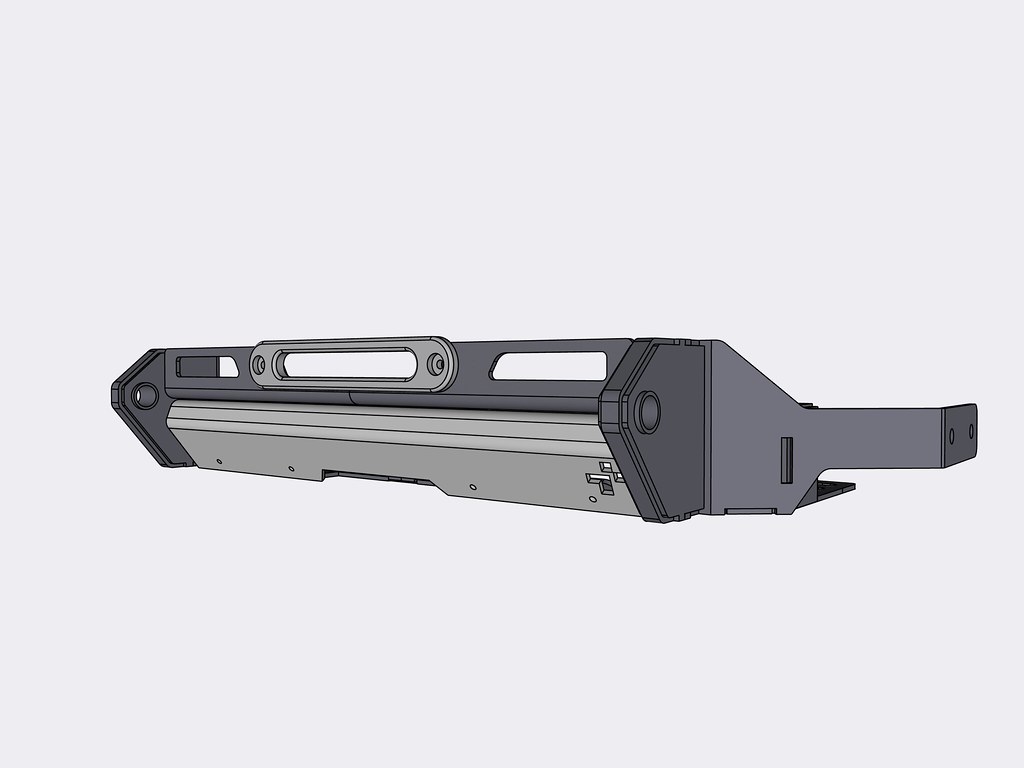

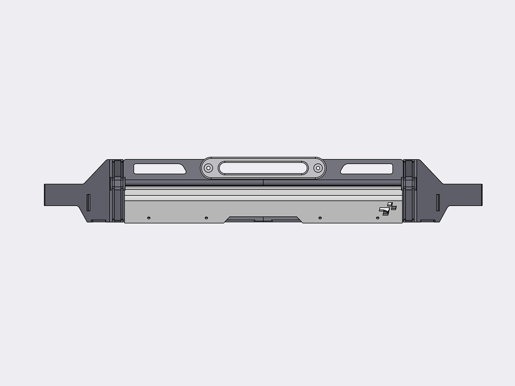

Just renders below before I prep the files for the fab shop. This is more complete than any previous version so a couple details to point out:
- Side rail gussets added to fully box in the bumper for strength; voids cut for weight savings
- Hitch receiver tube added with rear gussets
- Front skid plate redesigned to have multiple bends; an aesthetic choice from a design perspective to give more soft edges to help improve the real-world looks
- Most weldable areas are notched and puzzle together; this makes it easier than IKEA to build the plates on the truck and gives dedicated areas to lay welds (hopefully reducing average weld times and to help with product consistency in the real world - hard as a WIY product)
- Raised center section to be more even with recovery points
- Slotted various holes to help with fitment issues on trucks that are not straight on the frame ends or bodymount bushings
A couple notes:
- I found a way to cut production costs with less bends needed in key components, however I would have had to loose the tie-in to the front bodymounts. I feel that keeping this tie-in point will ensure there is less foreward flex of the bumper chassis during hard winching (and an impact) and therefore decided to go the way of more strength vs. cost reduction. Just something I wanted to point out as I spent a considerable amount of time working through this and even redesigned the whole bumper without the bodymount tie-ins - but in the end I think this is the right direction for the product.
Some current revision renders:
Untitled by Addison Rickaby, on Flickr

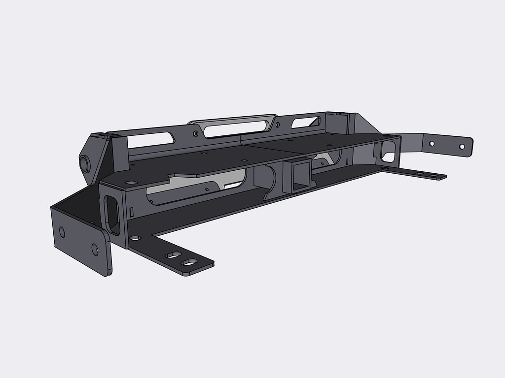

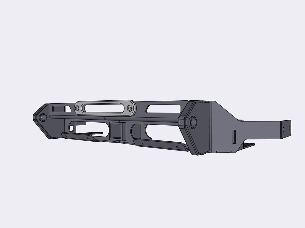

Front skid removed for hitch receiver and winch bolt access:
Rear side with gussets:
