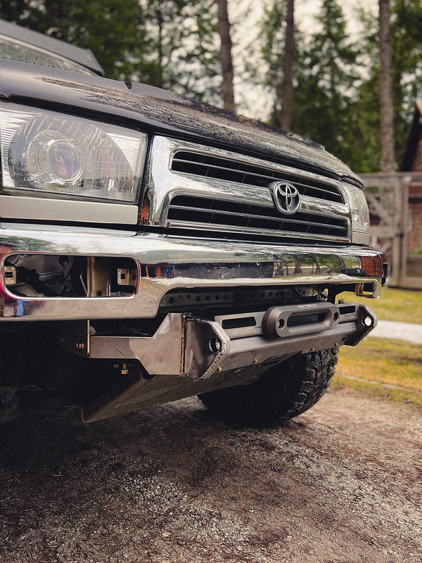

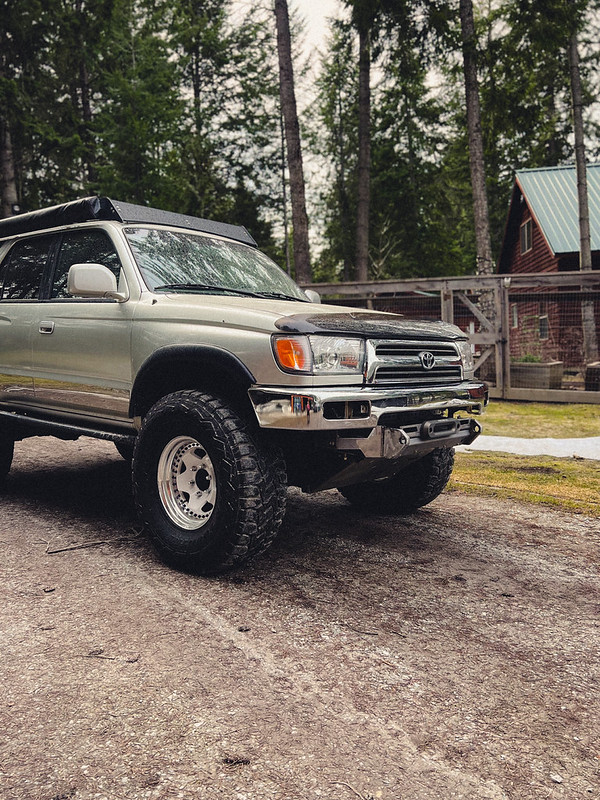

A couple quick updates on the weekend from those who don't follow us on IG....
[MENTION=82012]Tamarack.plus[/MENTION]

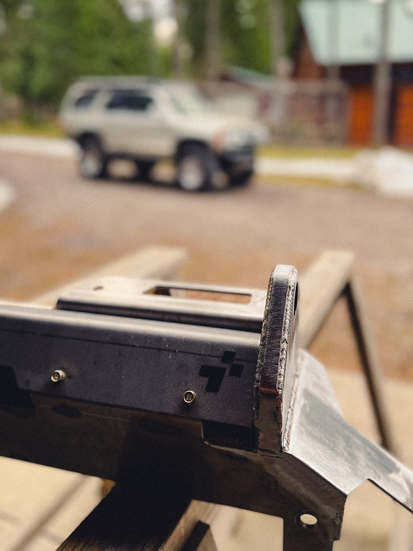

Got the base section of the bumper fully welded. I need to make a couple more dimensional adjustments to get fitment just right in the next update but things are looking good. I think I would have been able to weld it together and do weld cleanup in under 3 hours if I didn't run into the other issues that I will be correcting soon. That's fully welded with all the welds cleaned up and it pretty much ready for paint. I still need to build the wings, but pretty stoked on the simplicity of assembly of the base bumper.
I will say that at least 1/3 of that time was spent welding the recovery points that are boxed and plated. I am considering (at a cost increase) cutting solid 3/4" recovery points that require no welding to assemble (just welding to attach to the actual bumper). This would also allow me to get a nice chamfer on the ID of the recovery hole for those running soft shackles. Oh the trade-offs... it's certainly been an interesting process learning about the give/takes that each design presents. Especially when making a commercial and repeatable product, not just a single unit.
IMG_7530_jpg by Tamarack, on Flickr
IMG_7514_jpg by Tamarack, on Flickr
IMG_7512_jpg by Tamarack, on Flickr

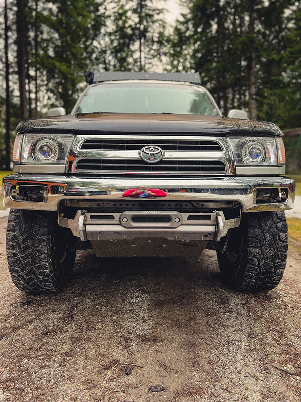

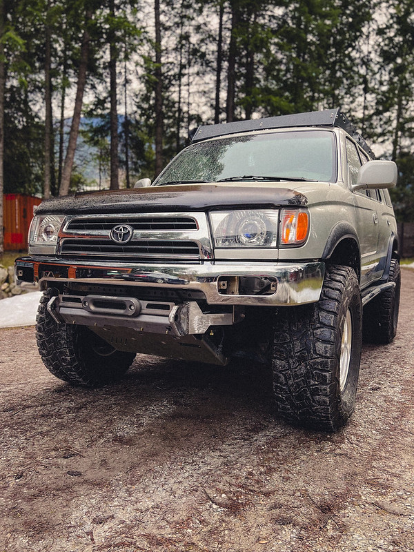

My biggest aesthetic qualm with the design is the flat corner that reaches out to the bodymount/factory bumper mounts. I do like how we are able to tie into this for strength purposes, but I need to fine tune the look of that corner as it just doesn't suite the rest of how the bumper flows. I've got some ideas on how to fix it.
IMG_7513_jpg by Tamarack, on Flickr
IMG_7515_jpg by Tamarack, on Flickr

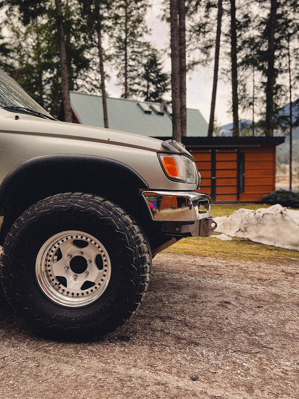

Side profile showing approach angle. Pretty stoked - and I've even been able to tuck everything about 3/4" closer in my current round of revisions.
IMG_7517_jpg by Tamarack, on Flickr
Up next are the wings. Sorry to all that my OCD is dragging this out. Group-Buy will come when I am satisfied with the product. It will be worth the wait! (I hope ;)
The overall bodyline flow, clearance, reduced weight, and retention of the OEM look on this bumper is just amazing. As these trucks become real classics, I find myself really wanting to stick to the timeless OEM look more and more, and this bumper checks that box.
