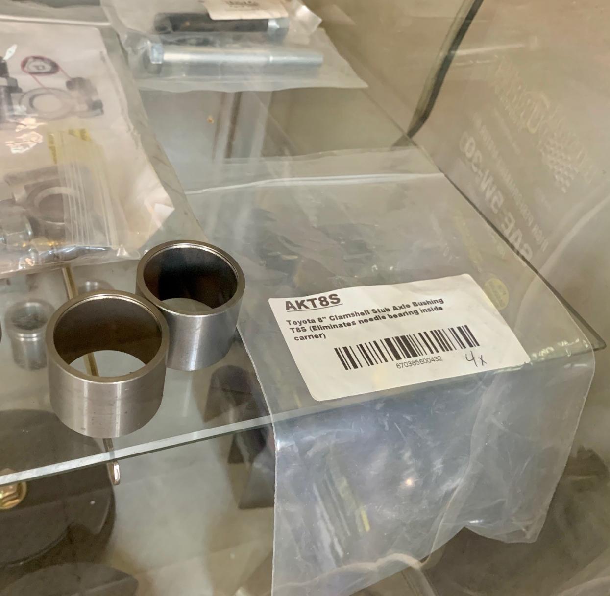

Read through this thread, a lot of folks have had this issue. I have the same issue and will be attempting to replace with the ECGS bushing:
Front Diff Grinding/Groaning Cyclical Noise

So yeah - you're not alone I would say. From the research I've been doing on the topic over the last 3 years the common denominator is that the same parts have been used in the entire chain of vehicles, and while I cannot say for sure its doubtful they have revised this part in the new ones so even if you receive a replacement diff under TSB identification it can have the potential to do the same thing. I just ignored the groaning every winter (presumably as the metal contracts in much colder temps the freeplay in that shaft / bearing assembly increased enough to make that noise considerably louder, never heard the issue in summer)
Anyway - after three trips to two different dealers to narrow that down, they all became no problem found results and service managers and techs alike never heard of an issue like that in these vehicles. Really? So that gave me a ton of confidence to have any of them pulling apart my front end to replace the differential assembly even if I could convince someone that this isn't a normal gear train noise.
Spoke to my local off road guy who's been changing those bearings out for the last decade really, primarily for lifted trucks of course with beyond stock CV shaft angles that develop the same problem and his go to solution is the same thing - replace the needle bearing. He uses the same thing as ECGS but he obtains them from Nitro Gear.
I just did this actually as I came out of 3 year bumper to bumper warranty. Should have done it 2 years ago really was so simple he did it in an hour for petes sake. Noise gone, dead quiet as it should be and we've had below zero cold in these parts lately I'd have heard the damn thing groaning away for sure. Anyway - thats my experience, good luck, seems like you're going down the same road - no pun intended :deadhorse:

I had a new front diff installed under warranty in January of this year, my noise has come back as soon as the temps dropped. I think I may just go with the ECGS fix this time around.

Yeah that is what the off road shop guy related to me when he was tapping in mine. He recommends his Toyota owners / customers with these diffs tap one in as well when doing whatever he's asked to do increases the stock CV angle because eventually - that needle bearing seems to complain for lack of a better term.
