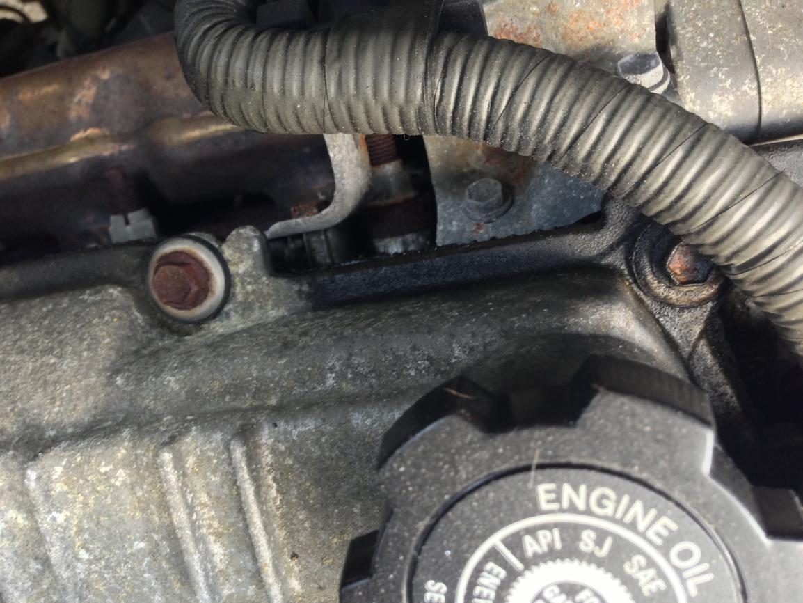

Oil leaking - valve cover gasket $475 (i'll attack pic of leak)

So overall I thought I came out with a fairly clean bill of health for my new truck. Attached is the pic of the gasket leak which I was told is very small and not to worry about it by mechanic friend.

Valve gasket pic.

The valve cover gasket doesn't look bad at all and that could even be from spilled oil - particularly considering it's just around the fill cap.

Valve cover gaskets. These engines are known for having leaky valve covers. The bolts back out and cause the leaks. Simple retorque them down again and your problem is solved.

He is right that the Valve Cover leak is not usually looked at as a imminent danger kind of issue. However it is something you should fix within 3-6 months at the most.

The valve cover bolts are prone to coming loose. Check and make sure they are not loose. Both my Dads Taco and my 4runner had a least three turns on the bolts. No more leaking after that.

My valve covers look worse than that and I still don't lose any oil. Im running synthetic too. IMO, I don't see a reason to do anything more than tighten the valve cover bolts if you are not losing significant quantities of oil.
