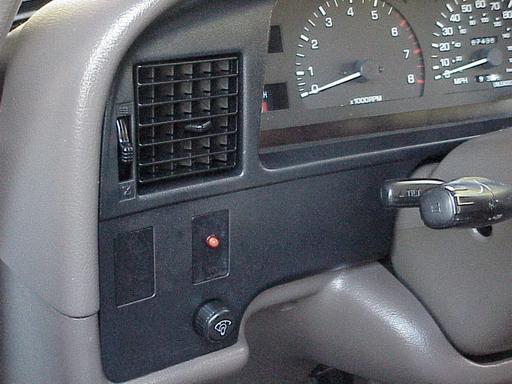

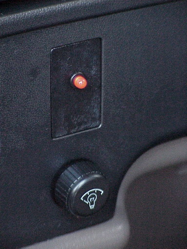

I just bought a 95 4Runner a couple of days ago and yesterday a little red light above the dash light dimmer switch came on and has stayed on. What is this light? There is no markings of anykind to indicate what it is.

No, I don't have my digital camera with me right now. The light is to the left of the steering wheel just above the dash light dimmer knob.
It really has me wondering what it could be. It stays on even when the vehicle is turned off.
I will get my camera later and take a pic and post it.
thanks
I'm interested to see the pic's especially since you say they stay on when the truck is off.

Here is a picture of the light.

That is an LED light and is probably for an aftermarket alarm or starter disable. Did you get a remote with your keys? If not I wouldn`t worry about it. Just put some black electrical tape on it until you can get some further information. This light could be removed or disconnected if it bothers you. If you want to keep the alarm/starter disable you need to find out where the wires from the light goes. The wires should go to a box of some sort under the dash. From there you can find out the manufacturer of the unit and order a remote for it. The remote will have to be programmed. I hope I helped out.

Yes aftermarket alarm or fake. You must snoop around under your dash or in the engine compartment.

That is either an aftermarket alarm, or someone wired an LED to make it look like there is an alarm.
You may want to check under the hood, see if there is a siren, you can also look on the inside of your steering column for an alarm box...
