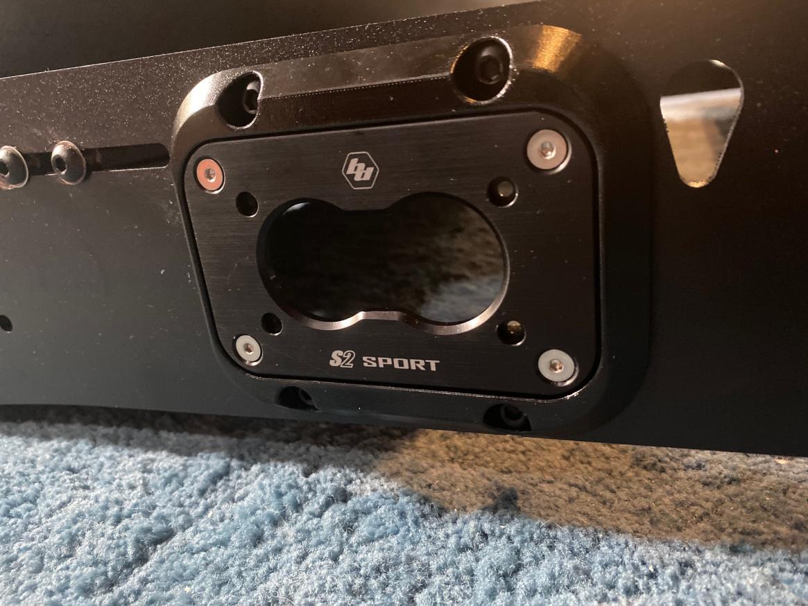

First I have S2 lights as scene lights on the Rhino rack this is replacing. Coming up with a good clean solution on the new rack proved challenging. The side rails have cutouts, but it was a Goldie Locks issue. The front was to big to use a Baja flush mount and the one back from it was to small. So I designed a transition part to use the flush mount and allow mounting holes. The part has nut pockets on back for the Baja hardware. Had them 3D printed then I painted them to prevent delaminate issues with water and freezing temps.

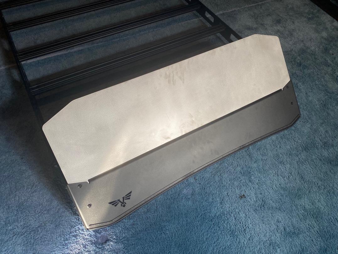

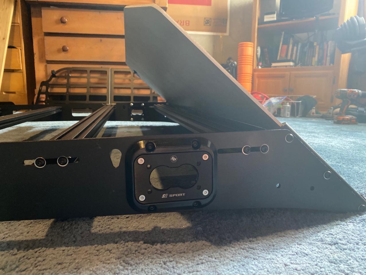

Next up was aerodynamics. I designed an aluminum fairing extension to direct wind over my brick RTT. I did a similar version for my Rhino that went from the roof and above the rack. Made a HUGE difference in wind noise and increased my highway gas milage average my 3 mpg! Those channels can make a lot of noise. Plus in the winter it will direct wind and crude over our skis. The design is the same thickness as the Victory. Is locks in above the racks fairing nuts and interlocks with the brake bend of the Victory fairing. It is fully supported with no hardware. Then 2 M8 SS powder coated BHCS on either end. Now it just needs powder coating. Gave it a little Victory design language on the top corners.

Your design for the flush mounted S2's looks great! Sent you a PM

Any chance you'd be willing to 3D print some more of those S2 transition parts. I've been trying to figure out how to flush mount some S2's on my rack as well and have so far been stumped. :help:

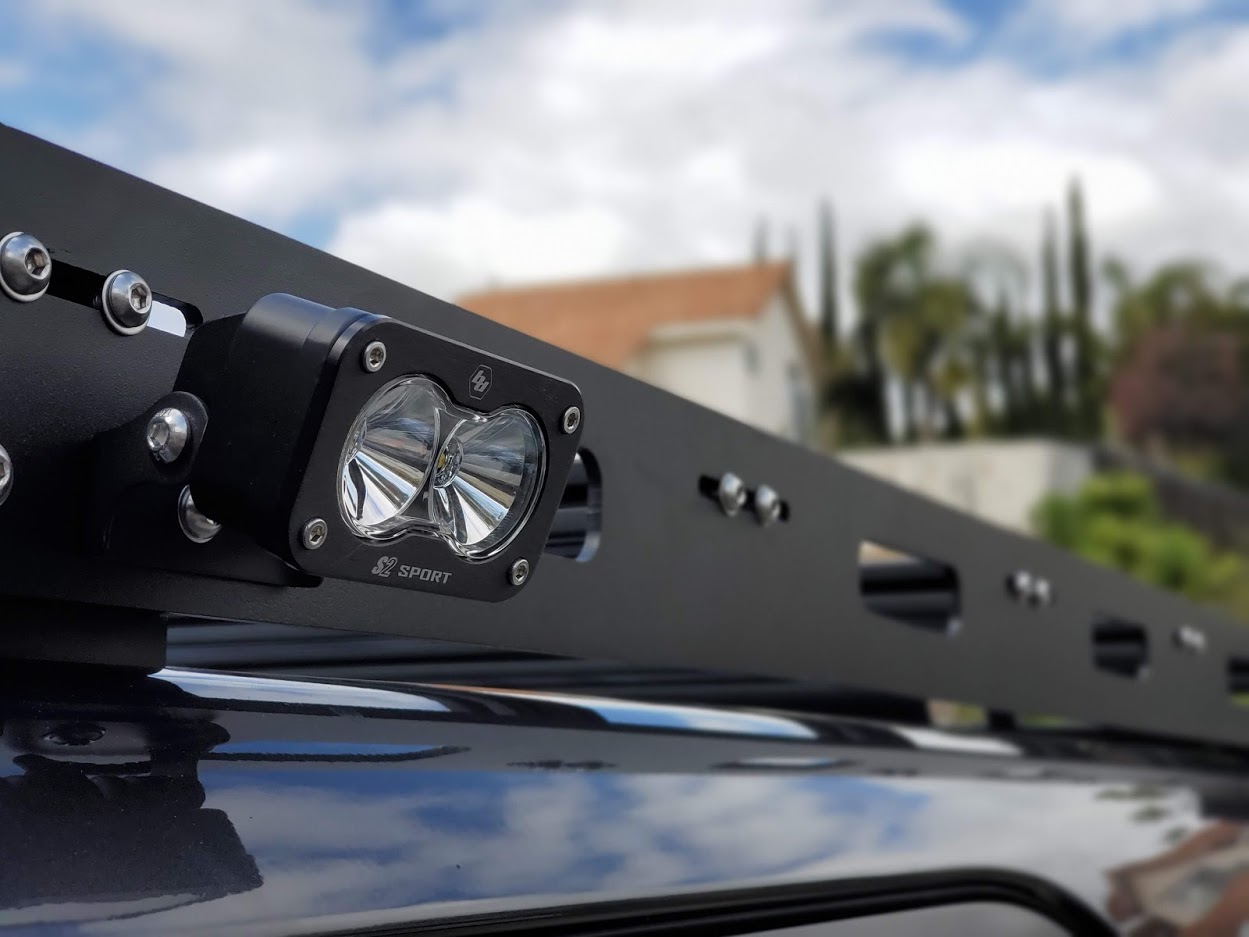

I've been trying to figure out the same thing. Looks so much cleaner flush mounted but I also want to be able to angle them downwards. This is how I have mine setup atm.
Just pm me with your e-mail and I will send you the files and info. No problem
That was my next consideration was to not use the flush mounts and just drill a single hole for the mounting bracket. I just love the look of the flush mounts more.
