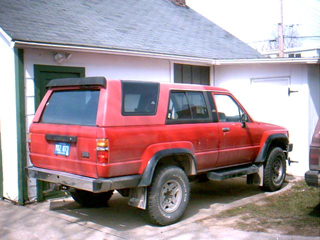

i'm running really late today so this one picture will have to do for now! i WILL get more soon!
oh yeah, i woulda taken one real quick from the front too but i parked too close to the overhang and some birds shat all over my hood. little punks!!!
