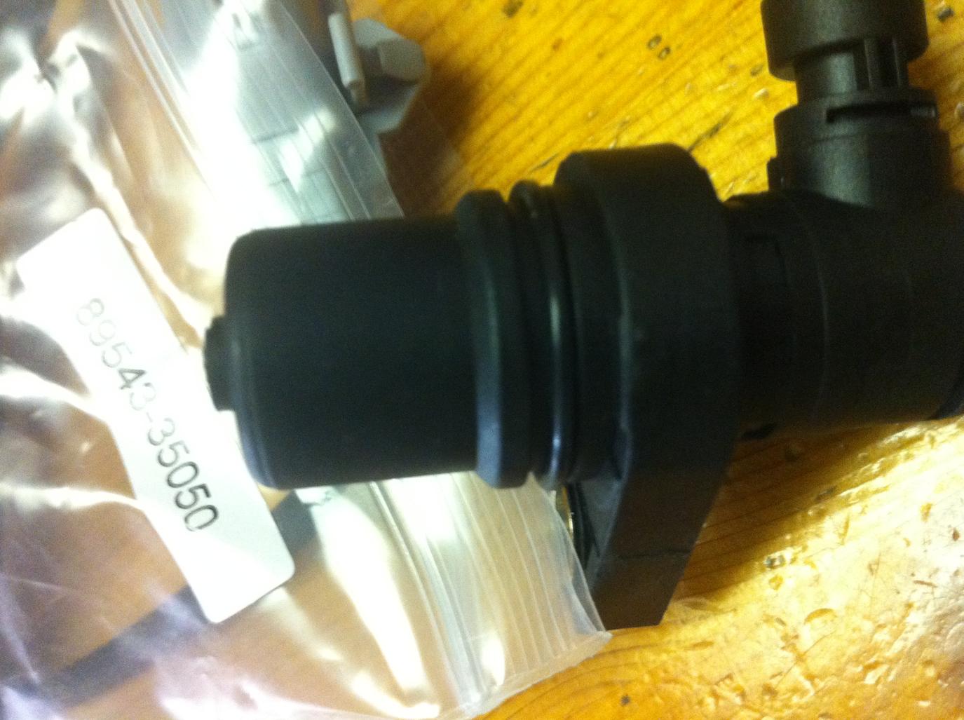

See where the hump is right before the o-ring, that seems to be where it is getting stuck. So I should use some emory cloth and sand away?

Obviously not OEM. OEM is same cylinder shape top to bottom with the oring recessed in at the top . No protrusion out the bottom either just the two magnets also recessed in. Yeah I know the OEM is expensive ($170) Just sand that bore a bit and lube it up. If it still wont fit, I would take it back and try another AF brand.

Rather than sand the metal bore and get shavings inside the hole can I just sand the plastic?
Don't sand the metal bore, just don't. that has to seal to prevent moisture getting into the bearing and ruining it. I wouldn't shave the plastic down either for the same reason, just get yourself the right one, this one may not even reach down into the bore far enough to have te correct air gap with the reluctor tone ring which is crucial for abs function. You might get it in there just to discover that it Won't work.
Yeah, that's definitely not the right design for the ABS sensor. The tip doesn't look right either.
Since you haven't installed it, you should return it to the parts store. If at all possible, pull one you've got on there and take it in for comparison.
Perfectly fine to sand the bore with some fine emery cloth to clean up the stuff that build up on it from the inside. Being he's in NJ like myself, I guarantee there's a surface rust on the bore. Almost have to clean it up if you want to get the thing back in. I've had mine out numerous times and they wouldn't go back in unless I cleaned up the surface. You just don't crazy. Common sense really.
Thanks, took a while to sand it but I successfully installed. Lights are now off.
